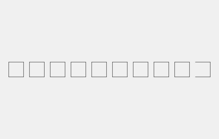

What I have seen everyone doing is to make a bunch of small boxes in a row, about 20 to 25mm square, that they assign different cut speeds to, similar to this:
The problem with this method is that the laser rarely can get up to that speed in such a short distance, so you are never really cutting at this speed. That is why many times you will have sections of your work that do not cut through usually on long lines or long circles and arcs, because at that position of the work, the laser has had time to accelerate to the true speed you have set.
