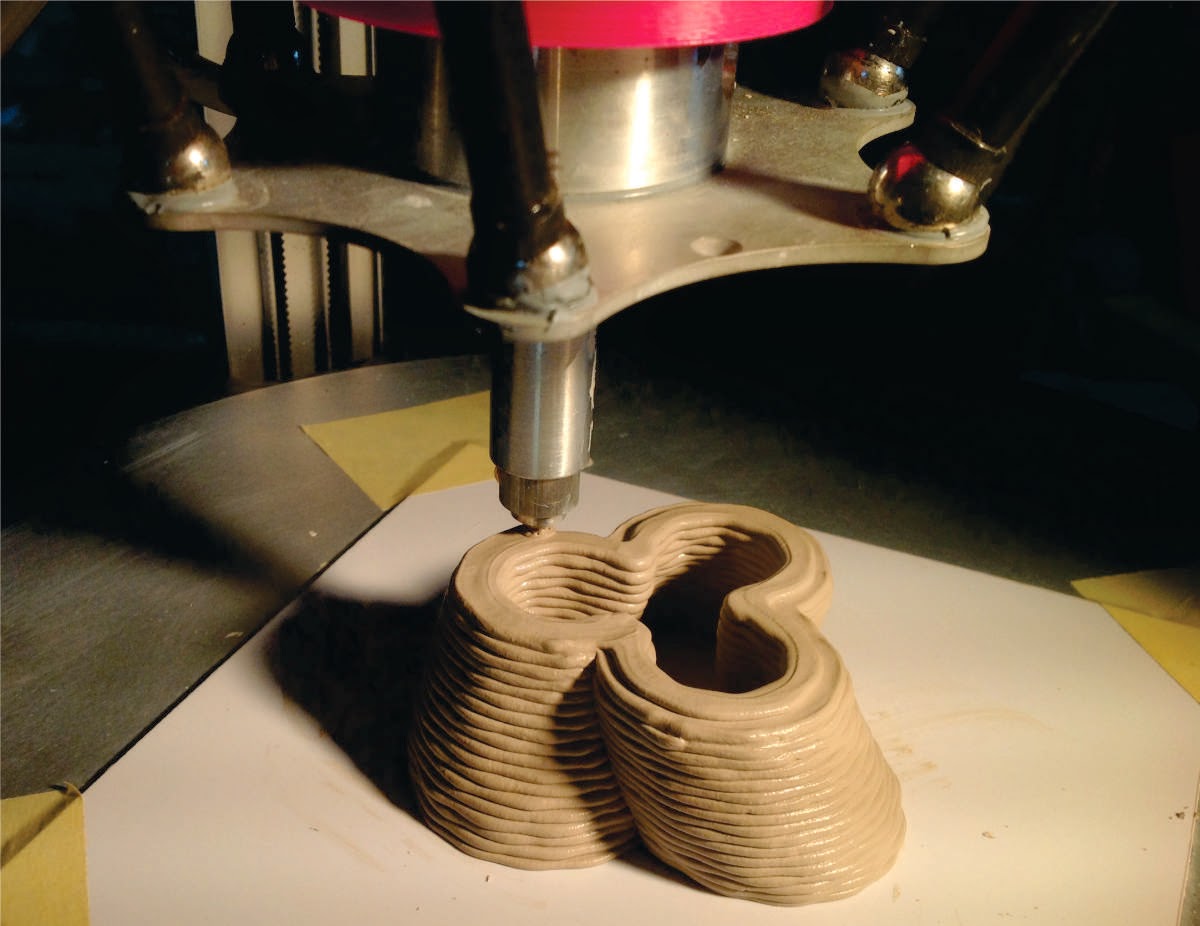

Mathias, is there any chance we would be able to control the flow during the print operation? As you can see from the attached photo I’m experimenting with producing a clay extruder and it would be beneficial to have a flow control. tks Danny
@Danny_Dd See in the options (section printer) : Change extrusion by X% (long press of extrude/retract during print to increase/decrease extrusion)
