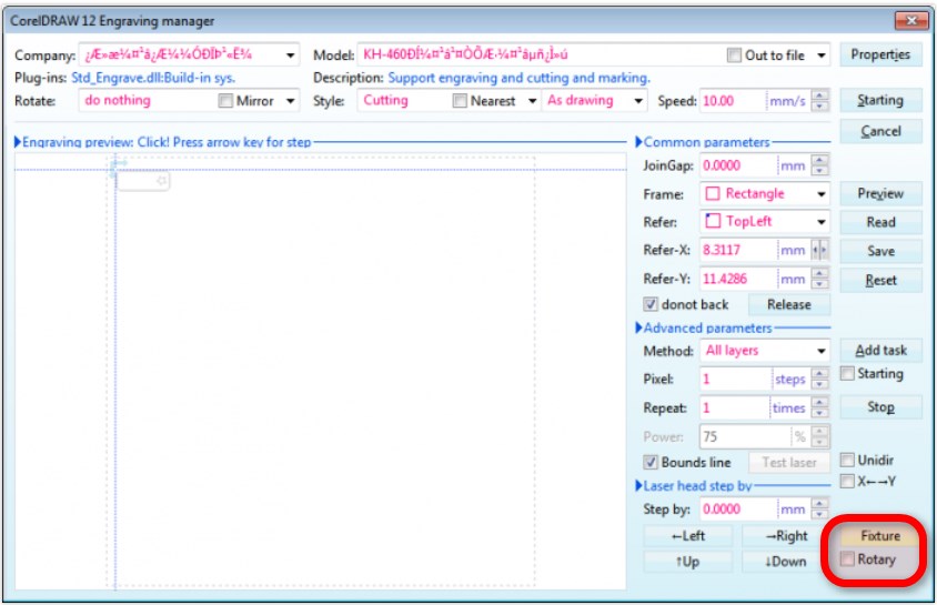

So you just change out the plug for the Y axis to your rotary, no changing any settings in software?
Linardas Verkulevicius under the Rotary fixture setting for a “standard fixture” what does Plus /round mean or do? Under “simple fixture” what does speed ratio do? Thank you for your time.
Hi, exactly, I don’t know what Plus /round means. But I guess it means steps per revolution, it is how many steps motor makes to do one full revolution (360 degrees).
I don’t know anything about speed ratio.
When I am engraving my glasses I set plus/round value at 1600 and I play only with diameter value. 30 mm diameter forks well for engraving my glasses.
I know it sounds confusing, but when I engrave glass with diameter of 50 mm I set 30 mm diameter in my software and the proportion of engraved image looks well. The result of engraving is showed in my video.
