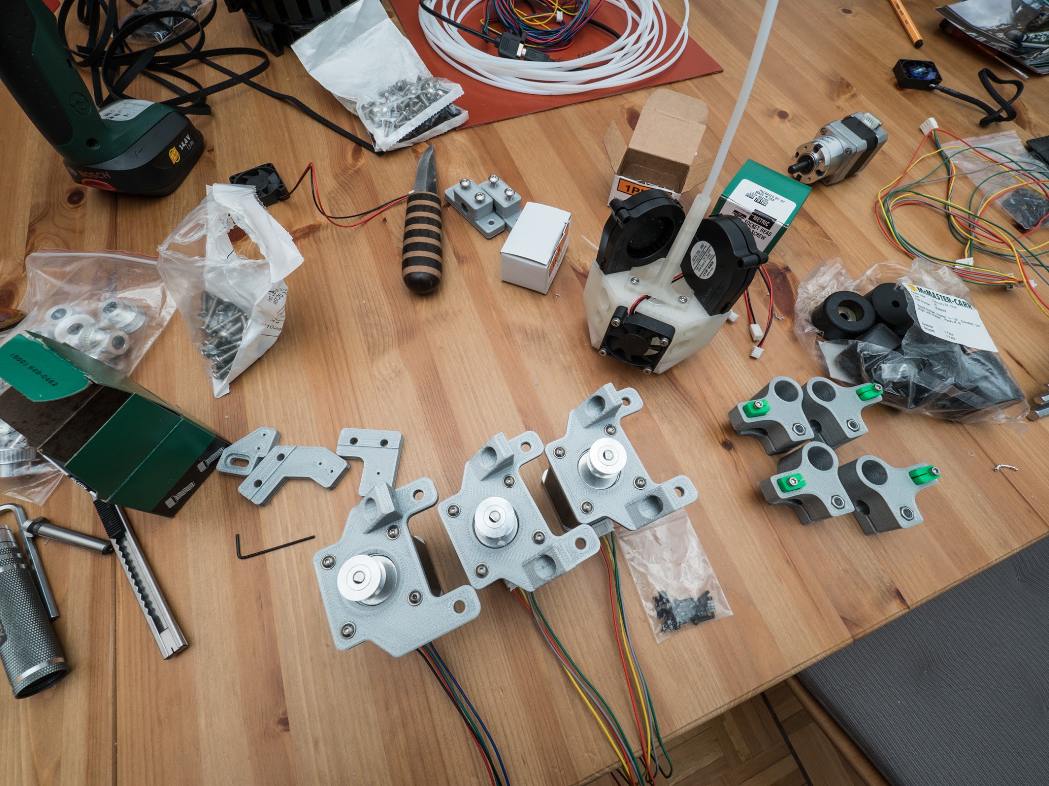

McMaster and Robotdig have arrived, this heatbed is huge
Most parts are printed, the big Z-parts are all in the printer since 27h, biggest multi parts print I ever done. But it’s running fine
Misumi package is for tomorrow

About endstops: Do you drill them to use M3 screws ? Or use M2 or M2.5 ? (which don’t appear in BOM list)
I drilled mine. There’s enough meat there and I hate having non-standard hardware in the build if I can help it.
One more thing for today, how does the heated mat hold in place against the aluminium plate ? heat resistant glue, thermal past ?
If you got the one from the BOM it would have an adhesive pad. If not you can get 3M 468MP tape to hold it to the bottom. I found good prices on that tape at http://zoro.com, and it is also available on Aliexpress (though likely not actually 3M brand, I think it should work just fine).
Those pictures bring back memories… Mine came with 3M 467MP Adhesive. I’ve also heard of people using high temperature silicone.
I ordered it by Robotdigg , it didn’t come with the tape. Thanks for the reference, it shouldn’t be a problem to find some.
