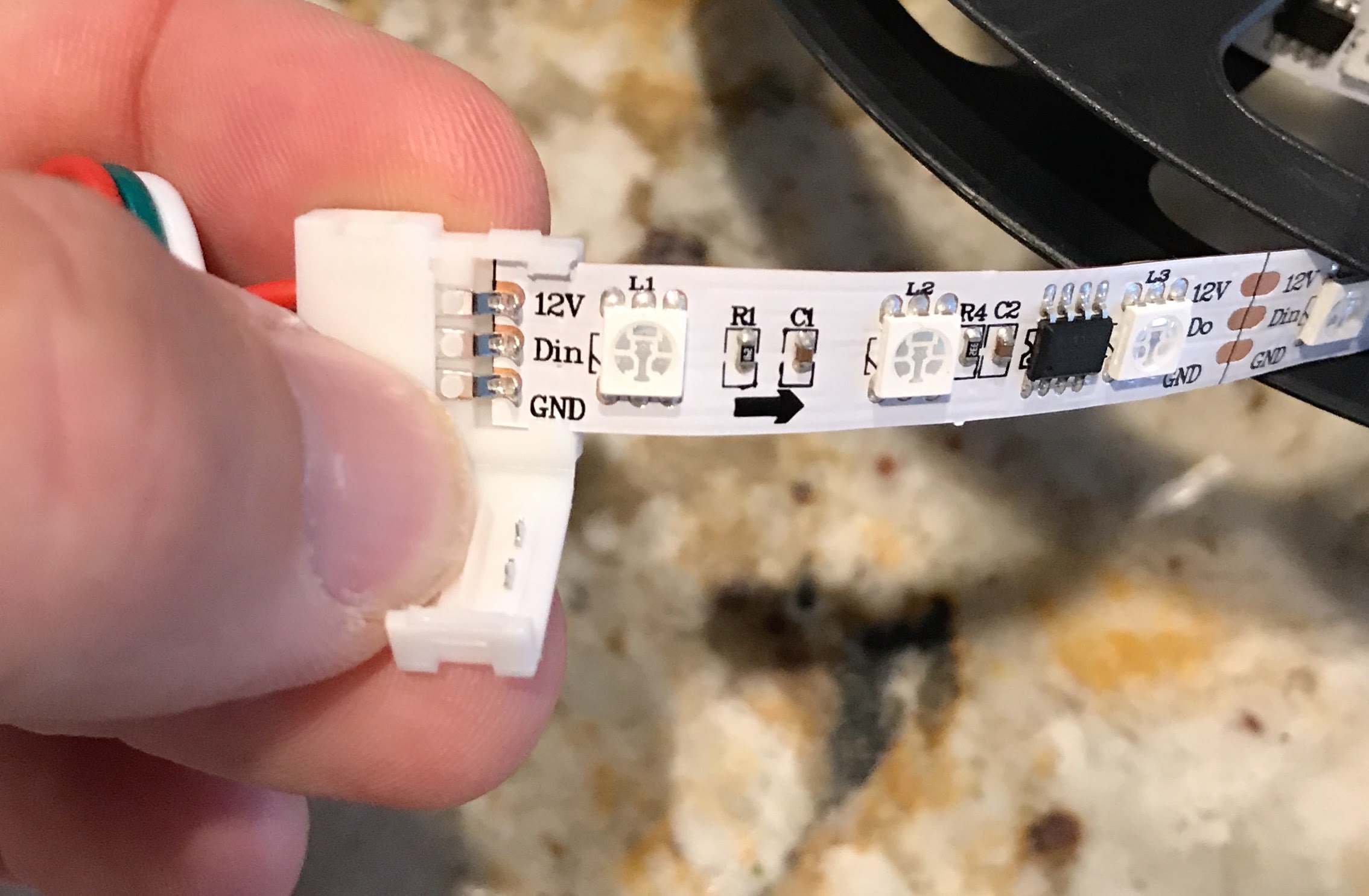

Me again, promise this is the last post. I am backlighting a TV and cut my 2811 in the right places and used these connectors in the photo. The nickel is physically connected right on top of the cooper on the 2811 strip. However it doesn’t work at all that way. The only way I seem to get it to work is by barly having it in fair enough and my theroy is that the nickel connectors are touching the metal in the middle of the strip not on top. Amazon warned me (via comments) that these connectors sucked. I figured it couldn’t be that bad but they seem to be. What is my best bet to ensure solid connections so all 4 stips power and transfer data accordingly?
Can these connectors be fixed, are there better ones? Are there any tricks I dont know about?
You could try gently cleaning the tabs on the strip with a sharp knife, but I’d just use wire and solder…
Thanks, ill give it a try. I have never used solder so worried I would just cover all the contact points by accident but I guess I should figure out how to do that
Yeah, I’ve never used those connectors, but I can’t say I’m surprised that they don’t seem to work very well. :slight_smile:
I would just carefully solder wires to the ends, or at least try soldering those connectors on.
If you haven’t soldered much, or if you’ve never soldered on strips before, I recommend practicing on other things, scrap strips, etc.

so a quick update… sandpaper 120 grit over the cut edge and lightly across the terminals seems to dramatically improve connectivity with these connectors. While I am unsure if it’s perfect it seems to be working pretty well (has not failed since).

Good work!! I’m not surprised sanding the terminals did the trick. I feel like there is a tiny coating of something on those. Solder doesn’t adhere instantly either, you kind of have to lightly scrape about for a second before it holds. They probably treat the whole strip with some kind of sealant/protector and there is a layer of that on the terminals.
I use these all the time now. I solder them to the pads.
