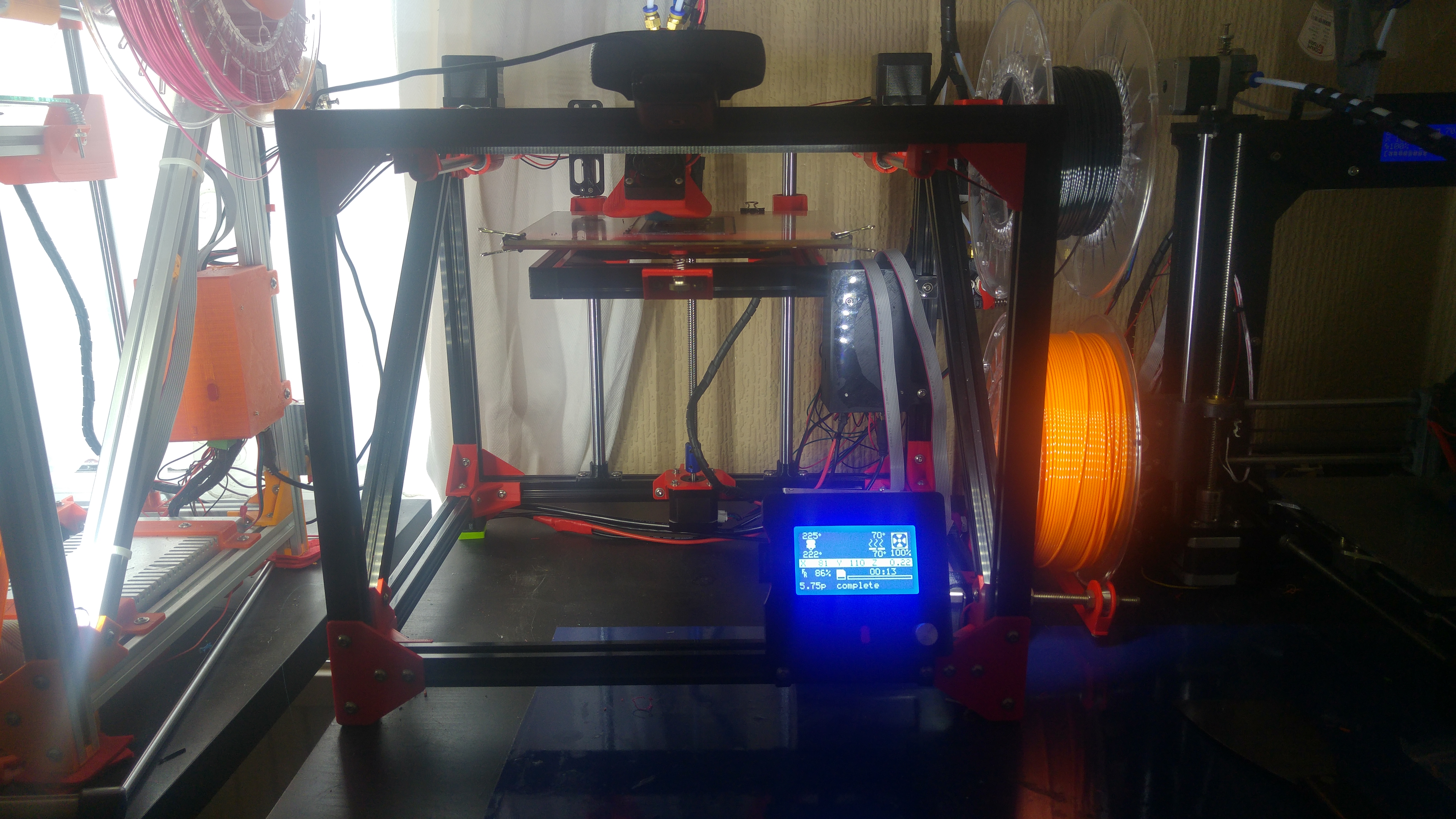

Meet FB2020 no.3 Harlequin.
Meet FB2020 no.3 Harlequin. Dual extrusion va my Y splitter design (still not nailed down yet but I needed it back with the farm). There’s stilll parts coming like an Aluminium bed and 240v heater, a 1mm pitch leadscrew and the Re-Arm board. It’s currently running hybrid voltages 12v on the bed and 19v on the rest (laptop power brick, 24v psu is on the way). 12v on the bed is due to the power brick not being powerful enough. Still, it’s up and running, and looking classy.
Nice, ya I cannot wait to see more of the dual exstruder in action. As well as how the Re-Arm will preform… I have one coming also.
@Jeremiah_Coley - aye, I’m going to be designing a piece where the PEEK tube just snaps into place to remove any movement from the bottom collets, so it 'll end up one piece.
As a note - I have a live feed at http://printers.sledz-uk.co.uk/ of 2 of the FB2020 printers, including Harlequin on a dual colour print, printing now.
