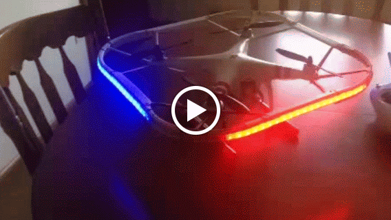

Messing around with this for awhile.
Messing around with this for awhile. Would love to Bluetooth the control side of this but for now it just loops through a few sequences. I’m not very proficient coding but it works.

That’s how I started - I haven’t touched a plane or a copter for more than six months now. :slight_smile: My flight toolbox is full of really cool new parts - still in their packets. My workshop bench is now a morass of cables, modules, breadboards, computers, connectors, power supplies, etc.

So how does it fly with the lights? Any changes in control response or flight time?

Flight times are about 1 min. less and she’s a little sluggish on takeoff. This is a Dji 1.1.1 Phantom and doesn’t have a lot of connectivity. Would be pretty easy to add a few modules to the arduino pro mini, allowing changes in altitude and direction to be detected.

@Mike_Eden I’ve got a 1.1.1 - I used the spare channel on the back of the controller to cycle through patterns - it’s really easy. You can also use a combination of switches. There’s a library somewhere for reading PWM and there’s a specific one for the Naza from the Arduino flight controller forums.

OMG! What are you using for a power supply?
Battery? Those LEDs only need 5v
@Mike_Eden how did you get on?
You can either use a step down voltage regulator or pull power from one cell of the battery through the balance plug. Just make sure you connect to only one cell (test it with a meter between two adjacent terminals on the balance plug. Your meter should read between 3.4 and 4.3 volts). Most of the time WS2812 are able to run on less than 5v. And lower voltage means lower current which in theory should make the LEDs last longer.
