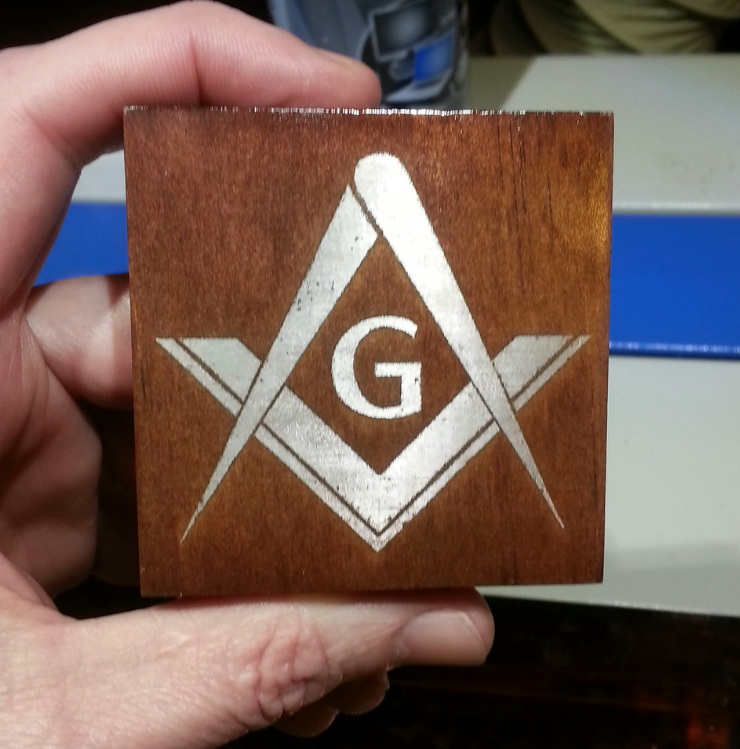

I came across a technique that woodturners use to inlay metal into their pieces and thought it would be interesting to try. Basically you fill an engraved area with powdered metal, flood the powder with very thin CA glue (super glue), let it harden and then sand it back. Did this piece in pine with aluminium powder. For only my second attempt (first was a big failure
it turned out pretty well. Some small voids where the metal powder didn’t settle into. Also with the finer grit sandpaper it was creating dark metal dust that settled into the wood grain and wouldn’t come out. Most of that is hidden by the stain though. Going to do some more test pieces and then I have some Brazilian walnut I want to try this on. You can also get other powdered metal like brass, copper, or bronze. After I get it dialed in I’ll do a complete write up.

I wonder if the void areas are a result of air bubbles in the glue or if tapping the metal dust down first (to have it fill its own voids) would have assisted?
Lol yes thanks @Yuusuf_Sallahuddin_Y , fixed that. The void areas are not bubbles, just areas of clear glue. The nice thing about the really thin glue is that it fills from the bottom up so eliminates the air bubbles as far as I can tell. Had lots of voids and and a few bubbles on my first attempt. It got a lot better on the second try when, after I flooded the powder with glue, I tapped the sides of the piece with a small wrench. The powder settled noticeably because the liquid glue was allowing the metal pieces to move more readily. Probably need to do a better job of tapping.

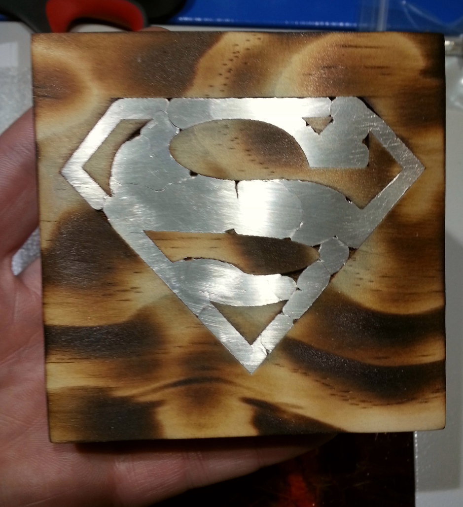

@Nedman Ah, I thought the glue may cause issues. That’s unfortunate. I’m wondering if it would be possible to melt the metal powder & pour it into the engrave area. Although I have a feeling that the temperature required would be too high for the wood to handle without scorching.
Or, is there a bonding agent that provides electrical conductivity? No idea. But, ideas have to start somewhere
@Yuusuf_Sallahuddin_Y It would be possible to melt solder into an engraved area. I did this superman logo using plumbing solder. This was just melted straight off the spool and dripped in, but would probably be better to melt a portion in a crucible and pour. Just burned the wood a bit and that came off when it was sanded down.
