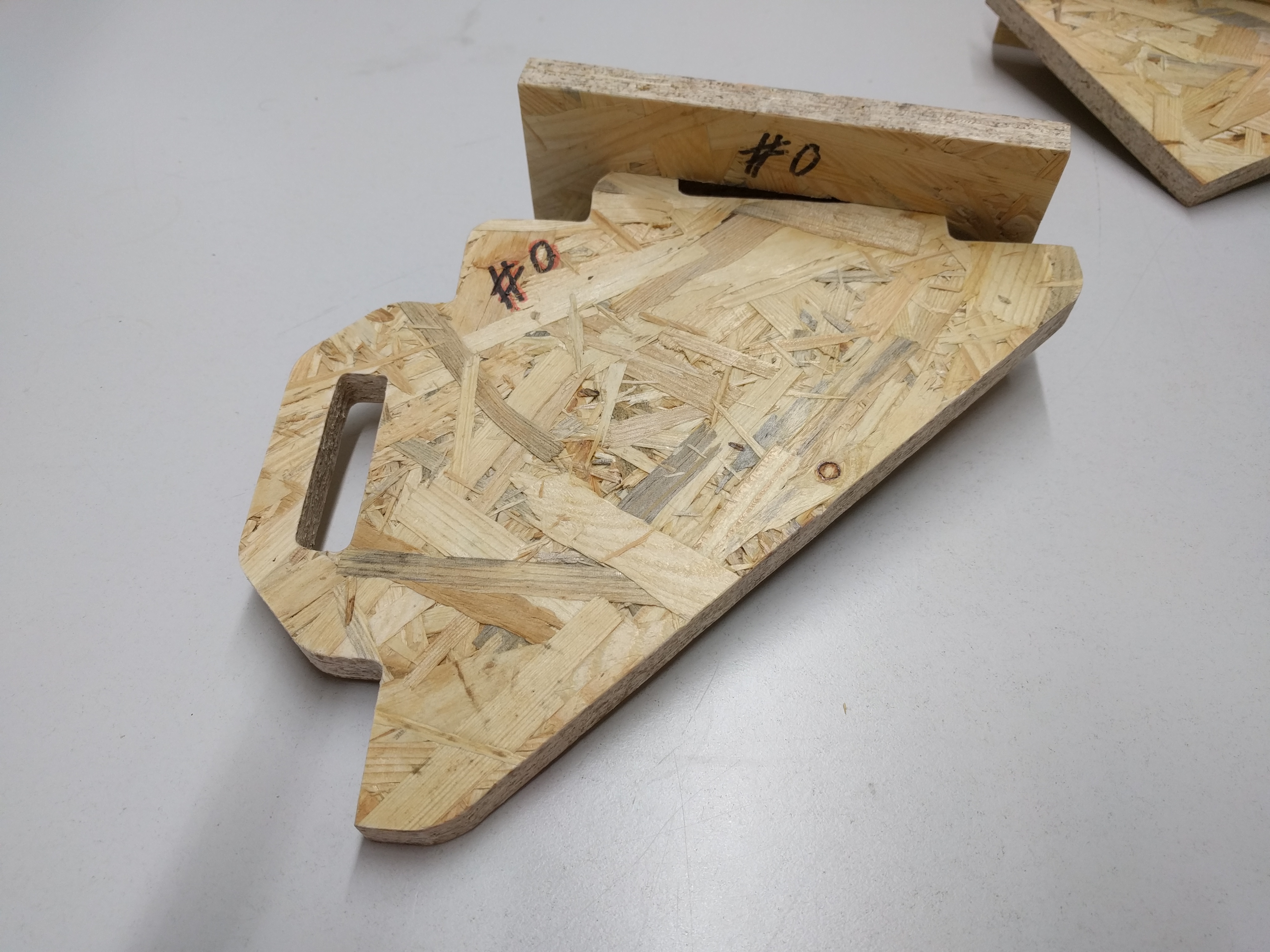

Mill Cut Outside with tabs
By now I did not care about the fact, that after each cycle the z axis retracks back to +1 before it dives in for the next pass. But since the MaslowCNC is very slow in thr z axis I do care.
Is there a workaround for this? Btw I’ve got no retraction without tabs…
You could try to split the job in two operations. First only the pathes without tabs and then one operation for the last path with tabs.
Sounds good. I’ll try that :slight_smile:
