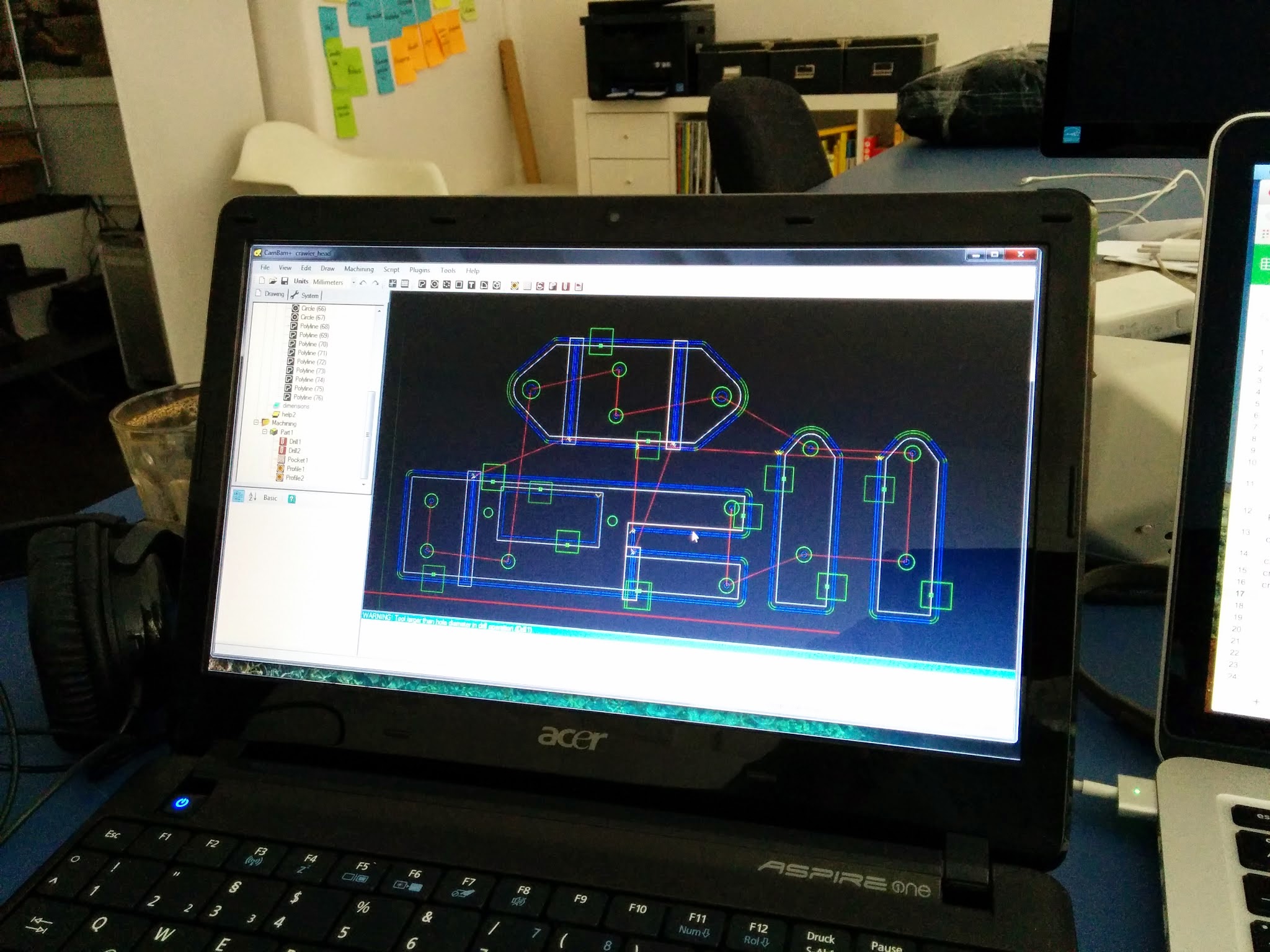

Milling 3mm aluminum with my Shapeoko2. 2mm endmill, 2 flutes, feedrate 600mm/min.

Nice. What CAM program do you use?
@Heath_Aiken thanks. It’s a Kress 800 at 21.000 rpm.
@Michael_Jacobsen I’m using CAMBAM. I’m still learning, but it seems to go quite well. Only missing a mac version.
