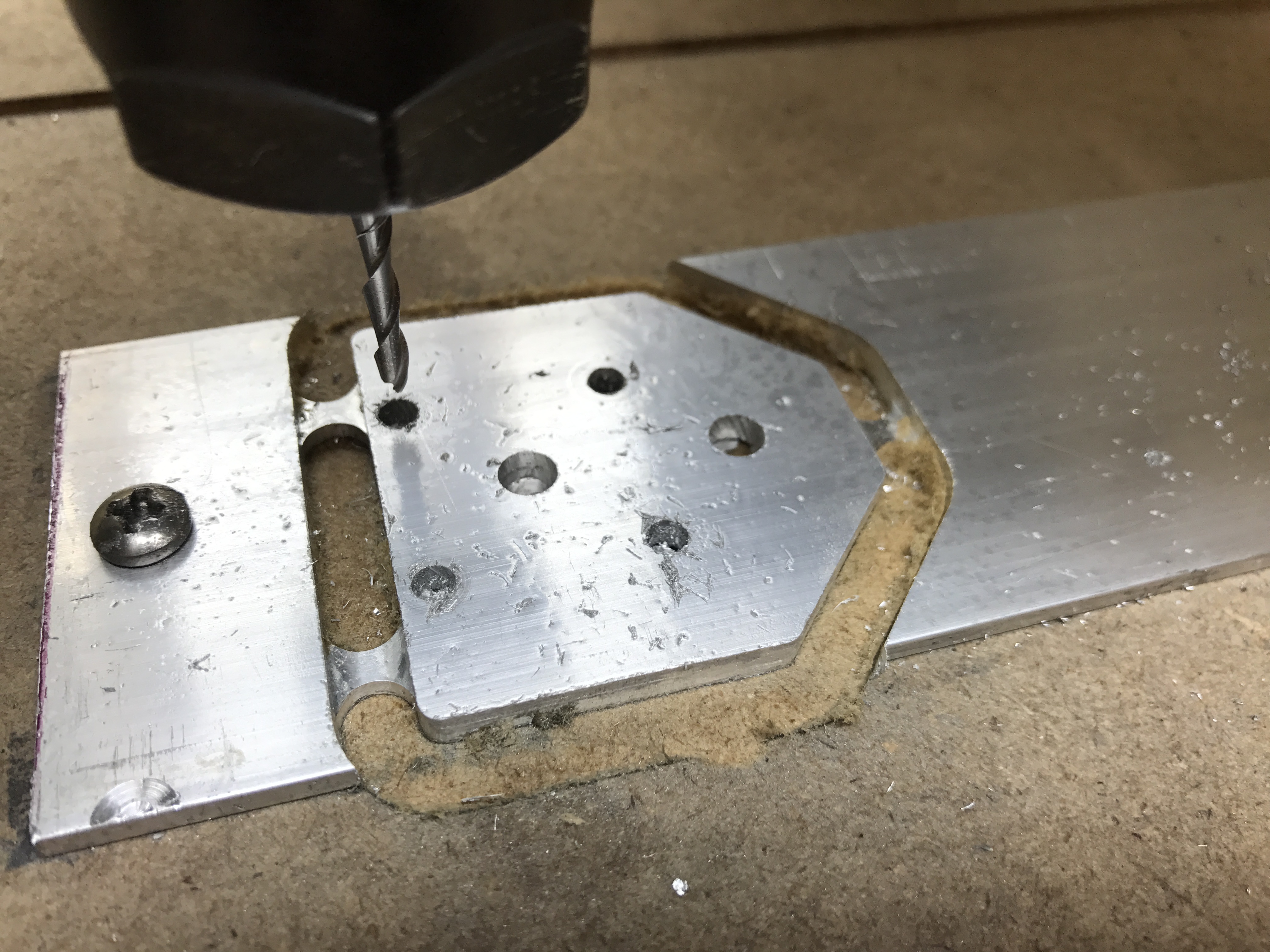

Milling aluminum parts for a scratch build 3D printer I am designing.
Milling aluminum parts for a scratch build 3D printer I am designing. Learning lots in the process. Chilipeppr and the tinyg have been pretty damn solid, only a couple of tinyg issues thus far.

If you have a Golf supply store nearby, get a roll of grip tape. Preferably the wide tape, but narrow will work too. It is a double-sided tape, strong enough to hold down aluminum sheets for milling. Just make sure your sacrificial layer is smooth, and free of dust, and press down with good force. No more tabs!
What feeds and speeds are you using? Is that 1/4" aluminum?
