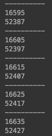

I’m trying a bpm (beats per minute) pattern with ~680 LEDs on a Particle Photon, but it’s animating super slowly. So I added millis() printouts at the beginning and end of the pulse() function to see how long it’s taking. The results are bizarre – it’s like the millis() timer jumps back and forth by 36 seconds!
See the attached screenshot for the weird timing results. The code is in the link below, and also in that thread, someone indicates that FastLED’s delay function may mess/conflict with Photon’s timer though

280696 - 316490 <-- 35794 milliseconds!
280796 - 316588 <-- 35792 milliseconds!
280896 - 316688 <-- 35792 milliseconds!
I’m calling this function every 100ms. My function is definitely not taking 35 seconds to run. :slight_smile:
