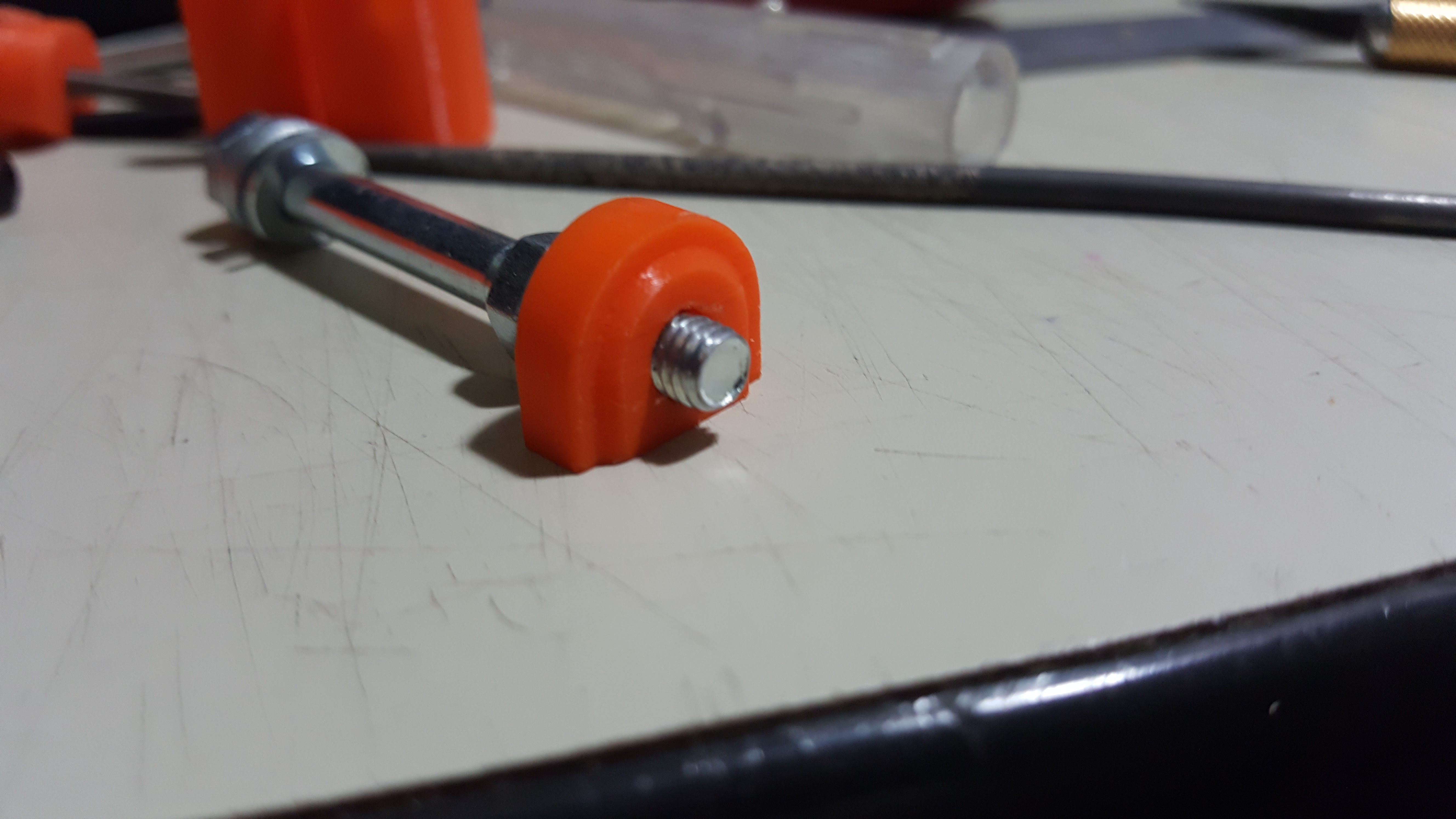

MiltyKoss super light linear motion extreme accuracy! M5 threads printed perfectly, first test print.
M5 threads printed perfectly, first test print. Some small globs internal needed to be cut away at the top , then the screw turned as smooth as a metal well made nut, fully captured.
MiltyKoss extrusion is under control with a sub-400mm bowden (350ish). At 2-3mm and no stringing to worry about. Near completion of a sub 300mm bowden setup. Swinging, turning, pivoting in all axis extruder mount, with the stepper COM at the pivot axis…
Super light delta linear motion, all printed parts, homemade bushings, my baby, so proud of this printer.
