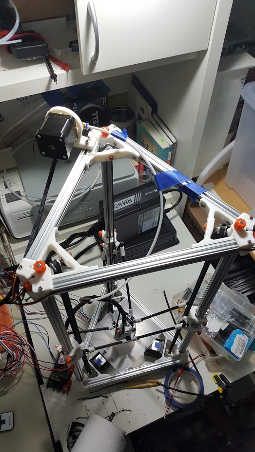

MiltyKoss unit 1 is alive! I still need to get some stuff taken care
MiltyKoss unit 1 is alive! I still need to get some stuff taken care of to calibrate, some decisions to make. Hoping you all can help!

Ugh, so my inductive proximity sensor LJ12A3-4-Z/BX does not sense anything but high grade steel. It detects a steel plate, but will not detect the aluminum build plate or a sheet of copper I have on hand to test it with. Any advice? It is connected to the 12v mains (per dc42’s advice on RR forum) so it should have enough voltage to work to specifications. its connected to the E0 endstop header and it is working with steel plate, it just doesn’t seem to detect anything else. LED brightens for steel at 4mm distance, does nothing for aluminum or copper that are in contact with the sensors head.
I already ordered an IR unit, after reading all morning about the issues with the accuracy and wiring of various inductive sensors. I would rather auto calibrate and level to the actual surface printed on anyway, but I would like to get this inductive sensor working if possible until the IR unit arrives.
