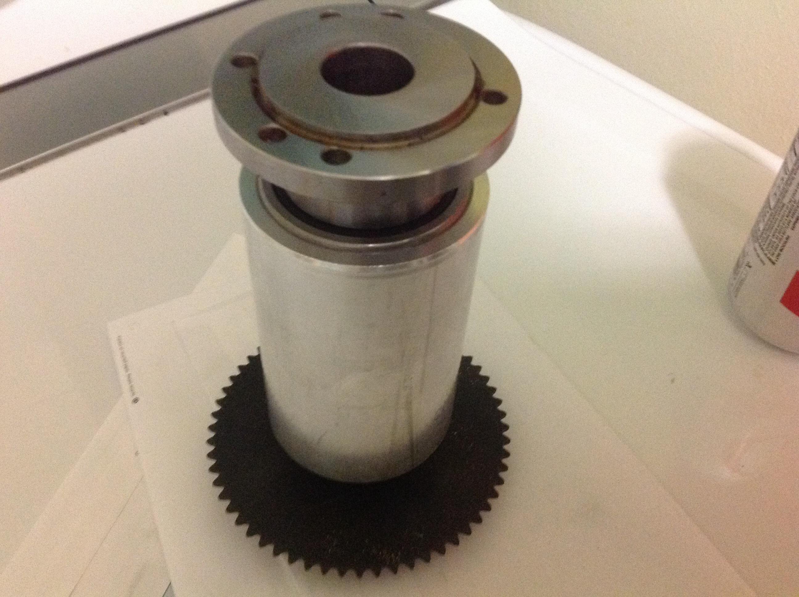

Mini lathe spindle mounted on bearings in 2-1/2 in.
Mini lathe spindle mounted on bearings in 2-1/2 in. AL schedule 80 pipe
Not sure if I am going to drive with DC motor or stepper. Right now I have a #25 60-tooth sprocket to use with stepper. Bearings are 6206-rs. Will see about casting block around spindle. Trying to decide between fiber reinforced concrete or epoxy granite.

I have enough bearings and pipe to make at least 5 more to experiment with. For prototypes, I am using cheap ABEC1 bearings. At about $2 each, I don’t really worry too much about them. If I find a solution I like, I will put the tapered roller bearings I have into it. I will probably put 1/4 in spines on the tubing to lock into mix. Once I find what I like, I have some 20mm supported rails I can mount to another block for a bed.
