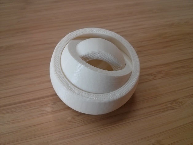

After putting my K40 back together and adjusting the mirrors again, I had an idea for a simple mirror holder. It is not new but can be expensive to purchase. It is to make a gimbal mount to hold the mirror. This way the center of the mirror never moves and you get a more accurate convergence. Below is a link to one on Thingiverse that I think can be modified easily.
Watcha think?
Interesting idea but I’m not sure how well you would be able to lock in the position.
