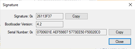

3.3V power light is on (without magic smoke) and I was able to program the DFU-Bootloader.hex without any errors (Flashmagic was also able to detect the LPC1769 processor properly). Other than the USB cable from my PC I don’t have any other hardware wired up or motor drivers installed. I did try powering the board off main(motor) power and got the same results below.
Once the bootloader was loaded I get L1 off L2, L3, and L4 on. If I push reset they all either go out or glow dimly (guessing IOs are in tristate.)

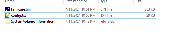

Grabbed the firmware_latest.hex and the sample config.txt per the directions here: flashing-smoothie-firmware [Smoothieware]
and loaded them to a freshly FAT32 formatted 32GB SanDisk Ultra SD card.
Popped that back in the board and powered it up. They same L1 off L2, L3, and L4 on pattern is shown with no changes over several minutes. The USB connection to my PC is not enumerated. I did read though the trouble shooting guide but did not see this LED pattern listed.
Pulling the SD card out after a few minutes and checking it on my PC shows the contents have not changed.
All 4 cards do the same thing so guessing I am doing something wrong on the software side or they all have the same hardware fault.
Just looking for direction on what I should be looking at for that led pattern.
Screen shot of the SD card directory

something is up with the bootloader if you still see firmware.bin on your uSD card after insterting it and starting the board. The normal bootloader loads and renames firmware.bin to FIRMWARE.CUR on successful load.
I got the DFU-Bootloader.hex file from here:
FlashMagic was able to program and verify the file. I was using version 13.31 build 6163
Under device I picked LPC1769, Com3 (verified correct for my FTDI cable), 38400
Under erase I selected entire device
Under firmware picked the DFU-Bootloader.hex and verify after programming
First did a read signature and got the following
after that I clicked start and it ran though programing and verify on the status bar before just going back to this screen. (no error messages were displayed)
Thanks for any help!

Ok swapped out the files on the flash card with the files from Cohesion3D with no changes. The LEDs do not count up at any time. More or less as soon as I power it up L1 is off and L2,3,4 are on.
