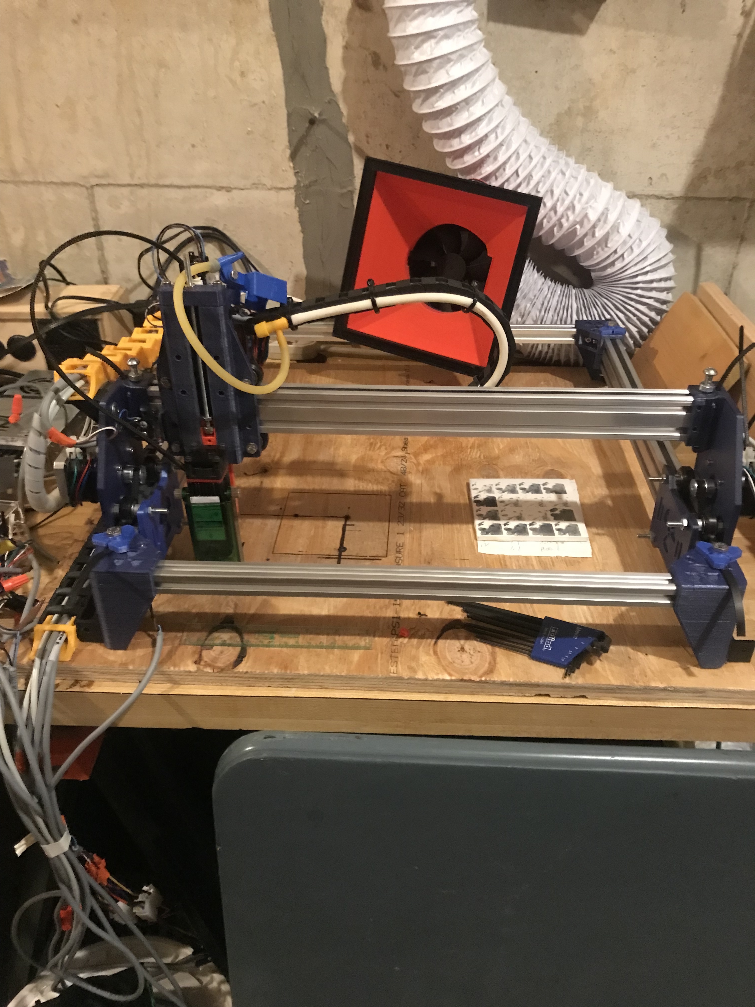

I’ve added some crude pics. One of my daughters cat I have trouble with Norton white tile method. I use Lightburn (brand new to it) and my controller is a mks dlc32 board running grbl (preconfigured by mks). Lightburn has helped some but I’m at the low end of learning the learning curve. I’m still trying to perfect the NWT method. But as much as I try to get settings that work for greyscale pic reproduction, it still leaves areas with patchy colors and sometimes the layers of pic shift over x axis and back. Now I scour the internet for possible hardware checks and firmware info to see if I’m mis configured! But I started this thread mainly to check firmware off the list of questions.

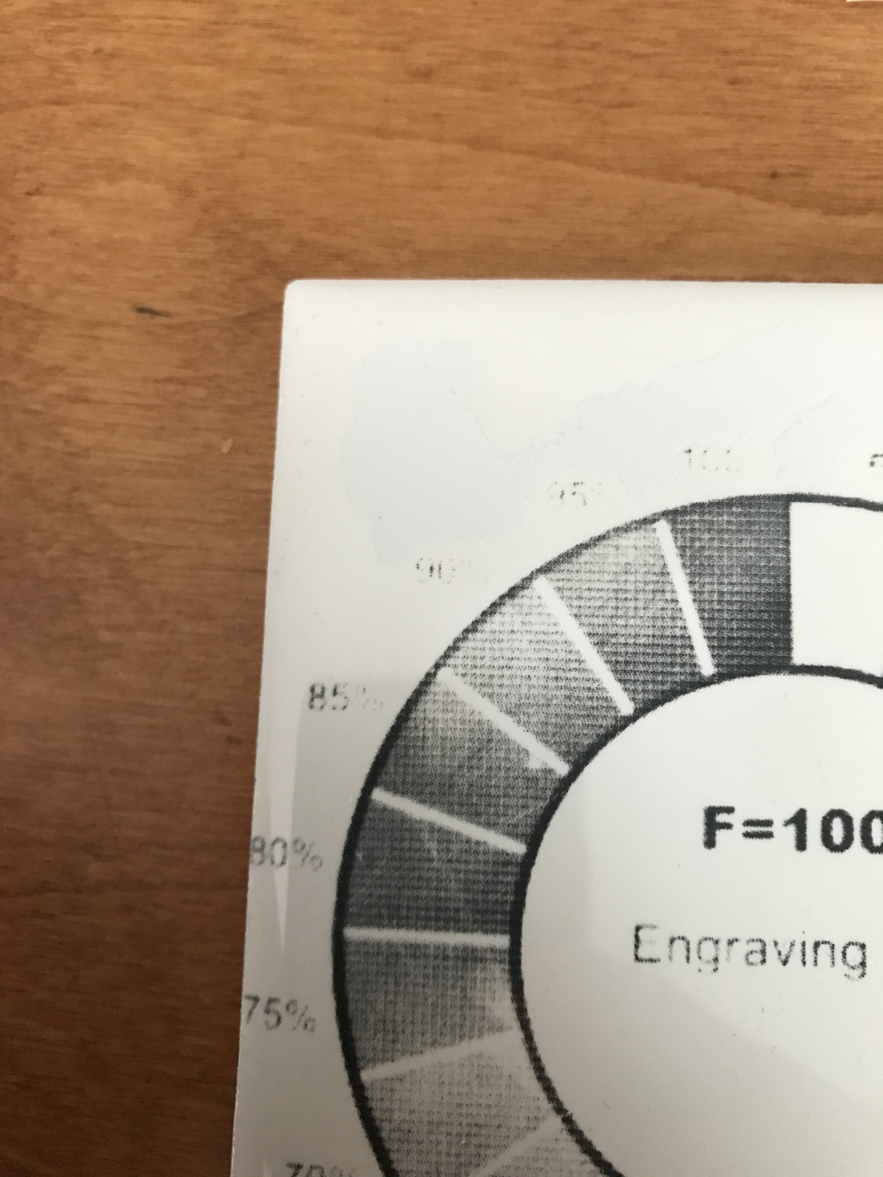

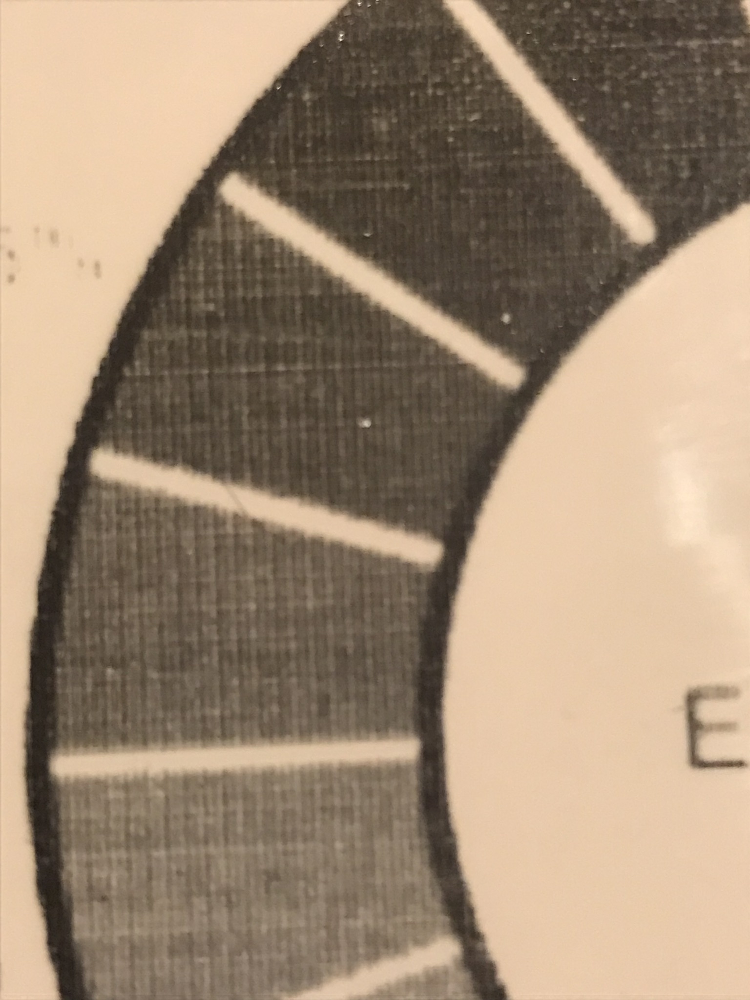

Here’s another pic close up of cal wheel. There’s a perfect pattern in the grey area. It baffles me how I could have done that. Everything seems to move just fine mechanically but really I don’t have a lot of experience.

A layer shift is a no-no and that can be a number of things:
bearings binding on the x axis
anything hanging off and getting dragged along x is hanging up(drag chain)
motor driver over or under driven causing skipping steps
weak power supply to the motor
just to name a few.
As for that pattern you are seeing on the grayscale test wheel, have you tried setting the scan angle 45 degrees and see if the pattern follows?

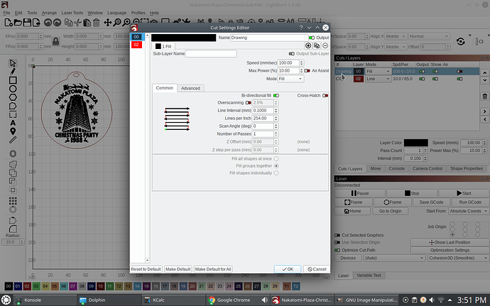

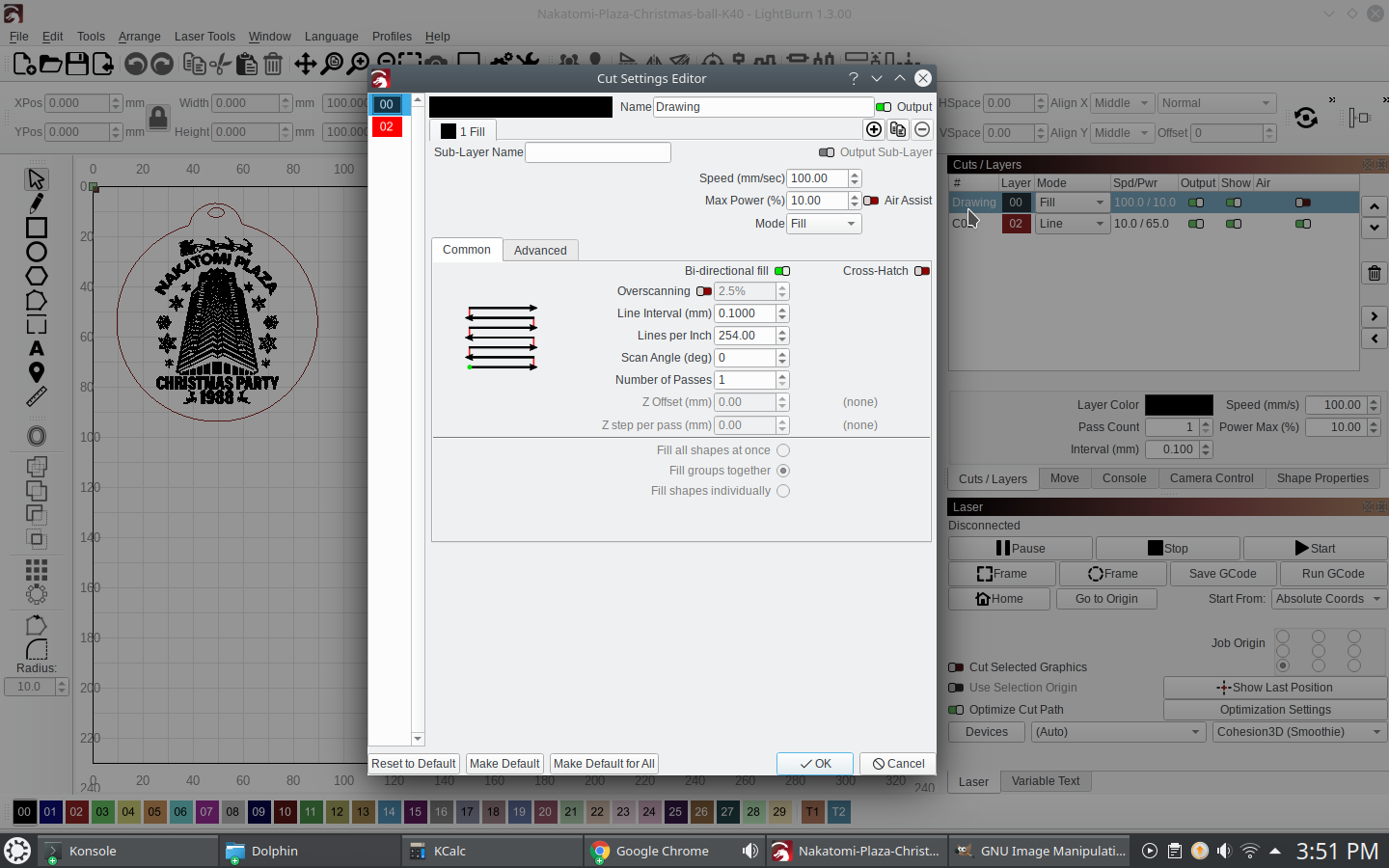

There are lots of videos on how to do things in LIghtBurn. FWIW, what I mentioned is in the layer setting where you set the power/speed/etc and is called “scan angle”.
Thanks for that!!
hi and thanks but im using image in my layer. i believe thats only an option for fill? im still learning how to use this software. iforgot to mention that the greyscale test wheel was a picture! my bad ! ill check videos for more raster instructions.
thank you
It doesn’t matter if it’s set to Line mode or fill mode. See the mouse pointer pointing to the Fill layer and see the dialog window open and the “scan angle” option? If you select Image mode it too has the same “scan angle” setting.

Here’s my first try at 45°
I’m gonna look at belts soon. Last time I looked they were tight.
Doesn’t it seem odd that you rotated the scan 45 degrees and yet the tile markings are still at 90/180 degrees? Also, unless you are fine going through tiles and paint for testing, I would be using wood and doing smaller tests. Even on the tile, you could be doing just a 1"x1" square pattern to test and move that around on the tile as you tweak and change things.
It is definitely worth the time and effort to learn how to make a 1" x 1" box with a grayscale level pattern inside.
Yes I shall! It does seem strange that it happened. Well I’m thinking about changing the firmware if there’s no change then I guess I need to take it apart and try and figure out the mechanical end. It definitely looks mechanical.
it looks like you are using Dithering for the image… that would leave the dot pattern in place no matter how you moved the raster scanning directions. Try changing the Image Mode from Dither to Jarvis or to Stucki and see what results you get.

I’m sorry I changed the scan angle as requested and the pattern that was showing up in the burn followed. As I mentioned I’ve since gone through and adjusted some mechanical aspects of the build. Most of the little vertical lines have gotten much better. Now I’m trying different line spacing to see if maybe I’m too close together. I’m burning smaller sized tests on the medium but sometimes it’s hard to see changes (old eyes). I’m waiting on a usb microscope to try to enhance what I’m looking at. Sorry I’m lazy at explaining. I’m working on that too. Lol
