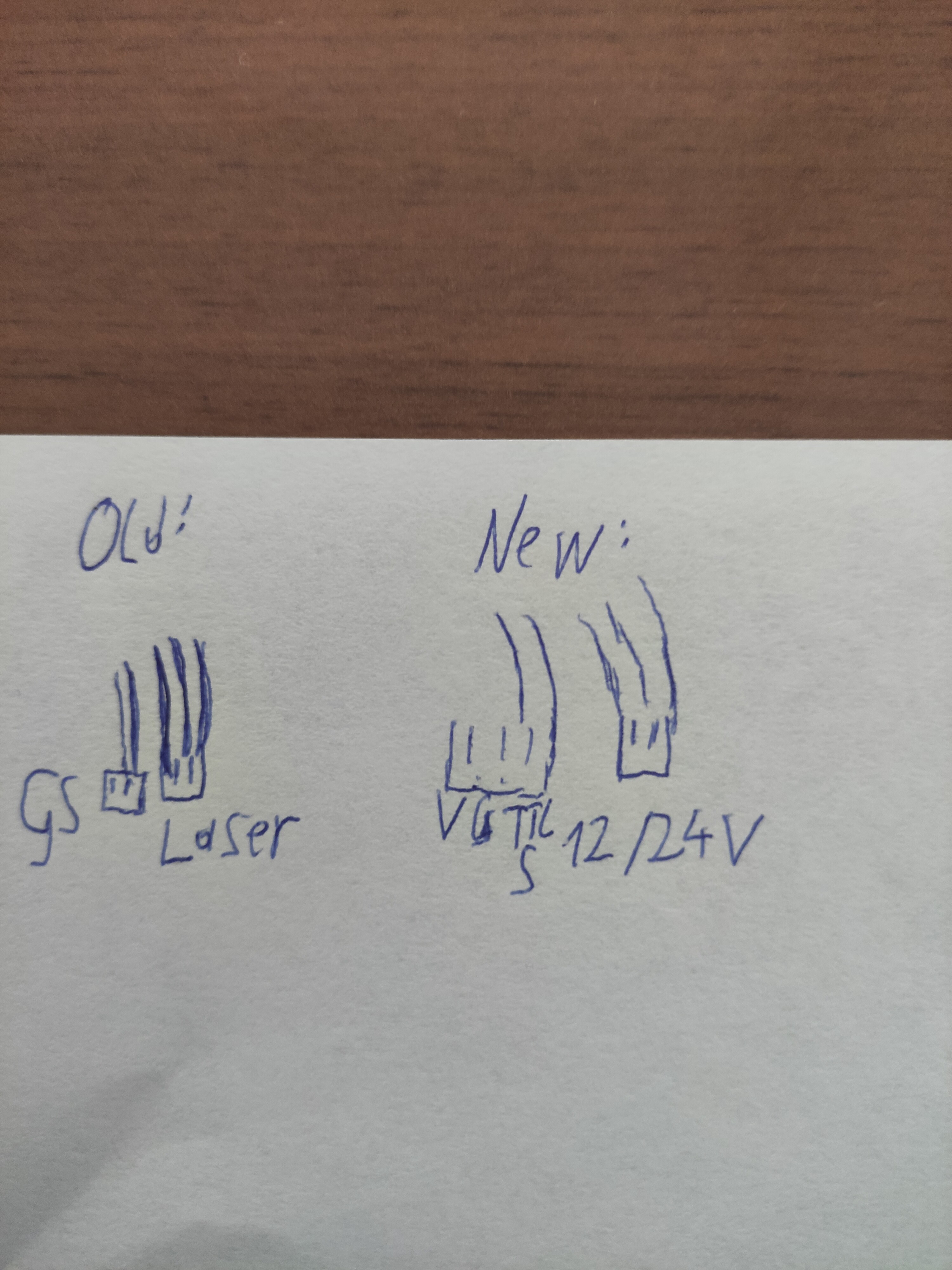

Yes, First I used it. Yesterday i thought it doesn’t Work because of this, so I did it Like this:Atomstack Official Laser Engraving User Group Public Group | Facebook (wiring 3)
Because of Method 3 i have a 3 Wire Plug now😁

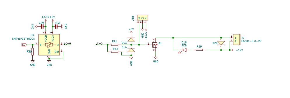

From what I can tell this wiring should work. J18 should contain TTL PWM, Ground, 12V {or whatever DCpower you are supplying to the controller}
I do not know what the pinouts for the M50’s inputs are so I did not label them.
I assume you are powering the controller with 12VDC?
I would check the voltages on the DLC’s connector first:
Check for 12V referenced to the Ground pin on that connector) middle pin.
While running a job you can measure the PWM signal just to see if there is changing voltage on it.
Is the above what you have ???

Can you provide a picture of your lasers connections?
How do you know what pins are assigned to what signal on that laser?
