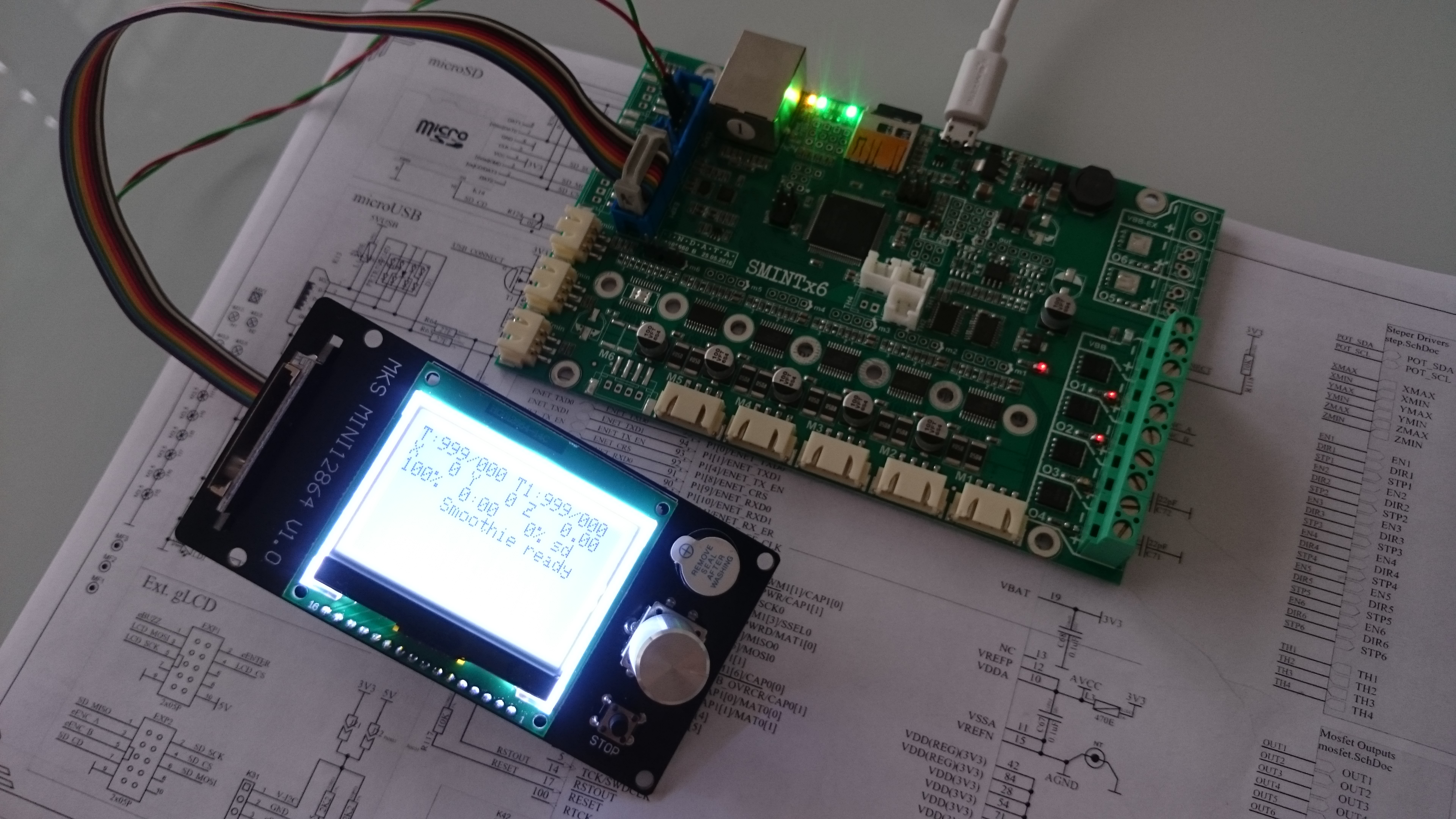

MKS MINI12864 panel on my smoothieware compatible board. LCD on panel is viki2 compatible but pinout on ext1 and ext2 is strange.
Both connectors are mirrored according to “standard” GLCD, LCD and SD shares SPI pins. But it works…

Are you running the MCP4451 digipots like on the smoothieboard?
Yes, you can set current in config file.

@Bray_pp I have been trying to get the MKS MINI12864 to work with a smoothie board for a while. Could you share the pin configuration and how you set up your config,txt file? That would be supper awesome.
