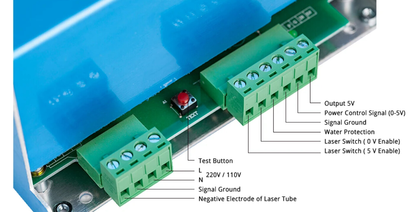

Is it also possible to control a 50W or 60W LPS with the SBase?
If yes, where goes the PWM Pin on the LPS as there is no “L” connector anymore?
How would this kind of LPS be wired up?
Thanks a lot & best regards!
Michael
Here is a drawing from another user …
Dwg* = Your LPS
T = Laser switch (5v enable): connect to “test fire” switch
L = Laser Switch (0v enable): connect to Bed- (L)
P = Water protection: connect to Laser switch, interlocks, water flow sensor
G = Ground, see the circuit
In = Power control signal: to the wiper of control pot
5V = Output 5v; to one side of the control pot
*The attached drawings LPS labels
Perfect, thanks!
Does it matter which GND to use on Sbase?
Yes, you should use the GND on the 12-24V power supply block. This GND is connectd to the MOSFETs. I’m not sure if other GNDs are connected to this one.
