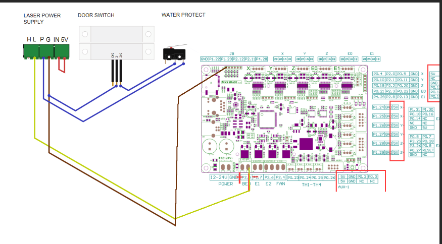

Also this schematic confuses me:
For my understanding the PWM-Signal has to go to “in” terminal of PSU and not “L”?
You don’t need any special voltage settings. The controllers control current through the whole circuit, whether there is one motor or two in series. When they are hooked up in series, if something causes a missed step, it will almost always cause both motors to skip a step; if you have separate drivers and a slight momentary jam it can cause the whole gantry to be askew and more likely to jam further. When it’s possible, wiring in series for either laser cutters or 3d printers is almost always the right choice.
The only common reason that separate drivers make sense, I think, is if you have motors with too high impedance and running 12V. Then it can make you miss steps from reduced torque.
TTL is an electrical communication standard: transistor-transistor logic. PWM is varying the on and off times of signals. You can send a PWM signal over a TTL interface. They are just orthogonal ideas.
Have you seen @donkjr’s troubleshooting document? It might be useful to you also for understanding the connections as well as for troubleshooting.
The best way to connect to the LPS is the L pin on the LPS. The controller should provide a ground (true) PWM signal usually through an Open drain configured MOSFET.
The wiring shown in the diagram as @cprezzi states should work. I recommend adding in the pot on the IN signal.

grbl-LPC has no option to invert the PWM signal by software, but I once added a configuration that uses the digital pin 1.23 (not inverted) instead of pin 2.5 with the MOSFET (inverted).
To compile this version you only need to edit config.h for using the MKS SBASE board (comment line 35 and uncomment line 38 and 42), then compile.
If you have a CO2 LPS like in a K40, you need to connect the negative pin of the MOSFET output 2.5 to the L pin of the LPS. This way you can set the maximum power with the potentiometer on the IN pin and let the software adjust the power from 0 to that max.

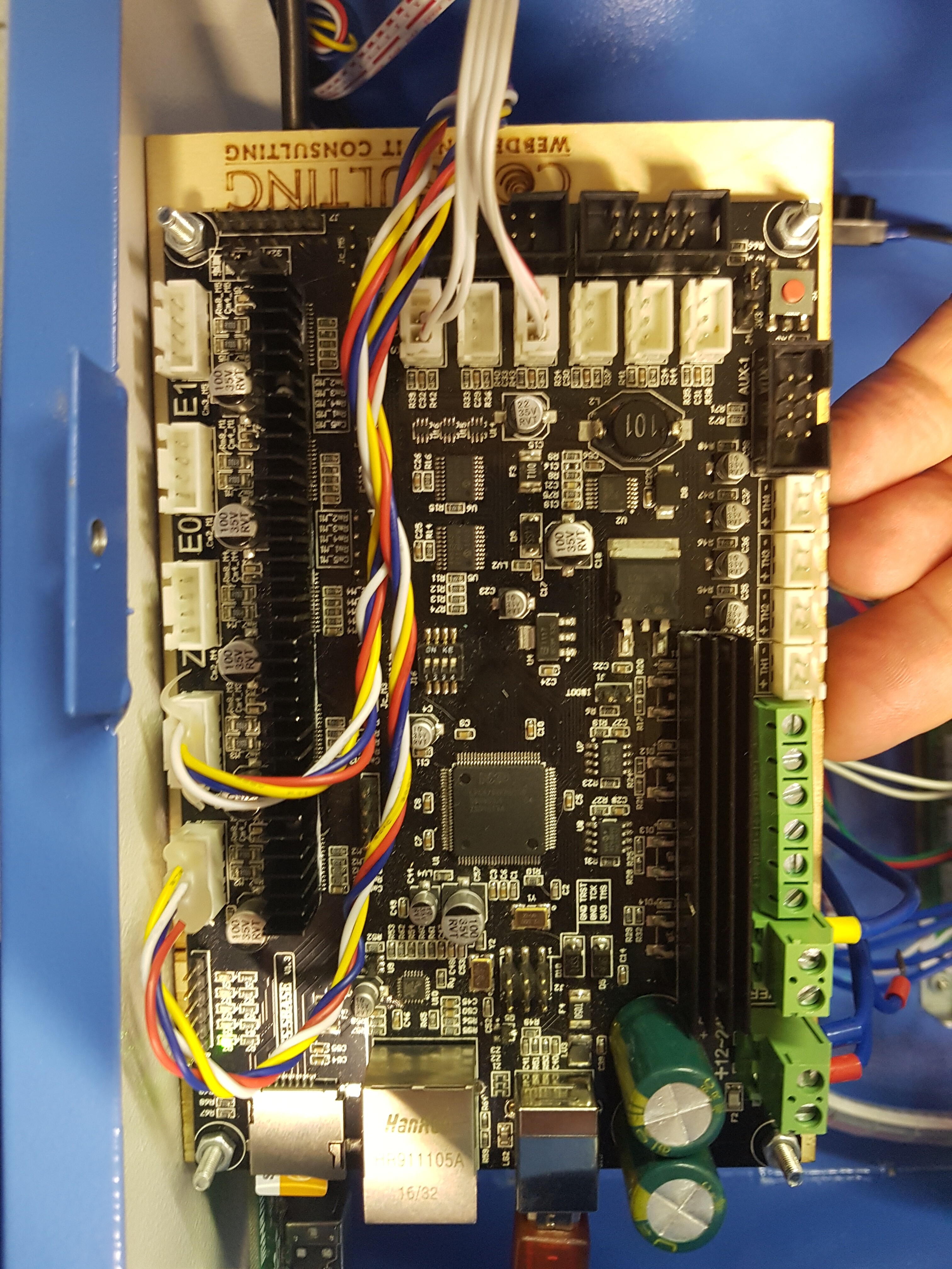

What LPS do you have? Are you only running 3 wires from the SBase to the LPS?
Not sure who this is addressed to?
The above has:
LPS-L connected to output 2
LPS- Gnd to a gnd on the controller
Yes, only 3 wires.
SBase LPS
12-24V VCC
GND GND
BED (-) L
