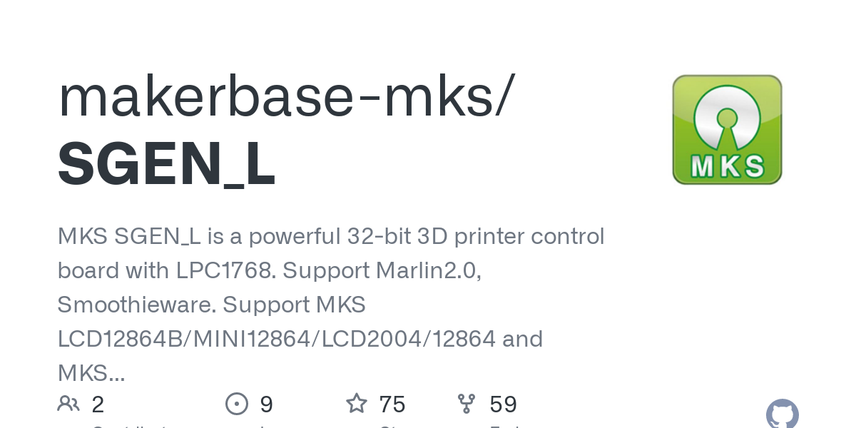

hi forum, can you tell me if I can load the smoothieware firmware on the mks sgen L 1.0 card? i want to connect to laser k40
what processor does it have?
LPC1768

You found that the controller does run Smoothieware and Smoothieware will control laser engraving machine electronics( 2 stepper motors and 1 PWM signal to drive the laser control ).
