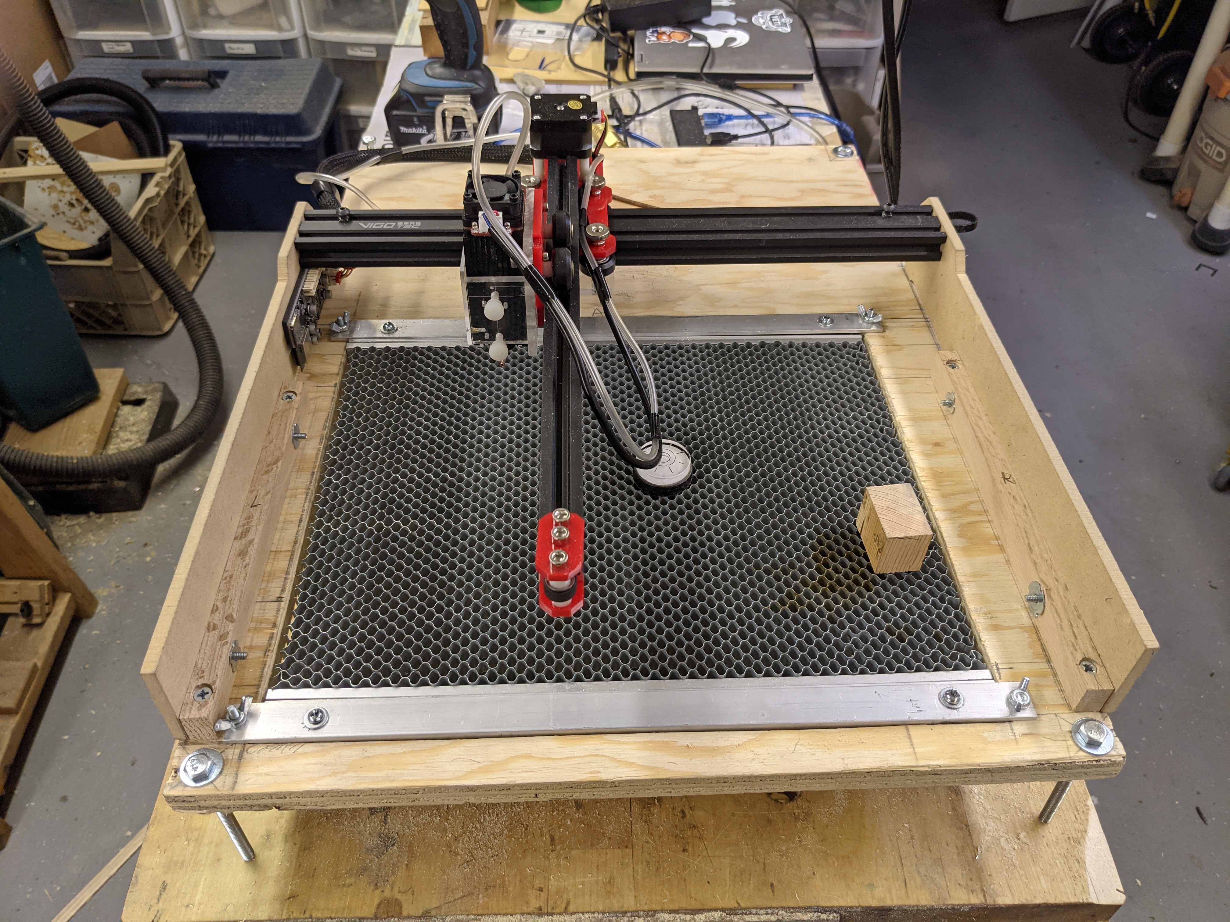

MObeam is intended to be a shop tool like a router or jigsaw. To that end, I focused on its mobility with the ability to engrave on finished woodworks of various types and sizes including vessels turned on my wood lathe. I traded off automation for simplicity and at the expense of more manual adjustments.
A fundamental concept was to leave the laser diode module at a fixed focus and instead move the entire assembly up-down as needed to get the target in focus. Sound crazy?
The laser focus is set at 30mm [G8 lens] up from the bottom surface of the base plate. The entire assy or alternately just the movable bed is then adjusted up/down based on the thickness of the target. In a way setting up MObeam is similar to setting the bit depth on a wood router.
The laser module gantry assembly is mounted on a piece of 3/4" plywood into which an opening is cut. This opening is left open or alternately accommodates a moveable cutting bed [one I bought for my K40 and never used]. The entire assemblies distance the surface is adjustable with 4 1/4-20 bolts
Very thick or odd shaped targets:
When left open the target is placed on the bench under MObeam and the entire assy is adjusted up/down with 4 legs until the target is parallel to the bottom of the base plate.
Small Flat Targets That Fit on the Cutting Bed
When the cutting bed is used it is mounted in the opening and 4 screws allow it to be adjusted until the target’s [laying on the bed] surface is parallel with the bottom of the base. The assy is mounted into the base plate with 4 thumbscrews. Adjustments are made with a 30mm gauge block.
Large Flat Work
If a larger flat material needs to be engraved [front of a chest] the gantry assy can be dismounted from the baseplate with 4 [thumb] screws removed from the side plates.
The gantry assy is placed flat on top of the target and no additional adjustment is needed.

Views showing the adjustments for the base plate and cutting bed insert.
Detailed views of the bed adjustment mechanism.
Yes I know, I cringed when I started this design …
However this assy worked better than I expected. Then again I took a lot of care to ensure the holding bracket and the bed mounts were perfectly aligned. The adjustments [one screw at a time] were not as clunky and painstaking as I thought and it did not bind until I adjusted only one screw a ridiculous amount relative to the others.
