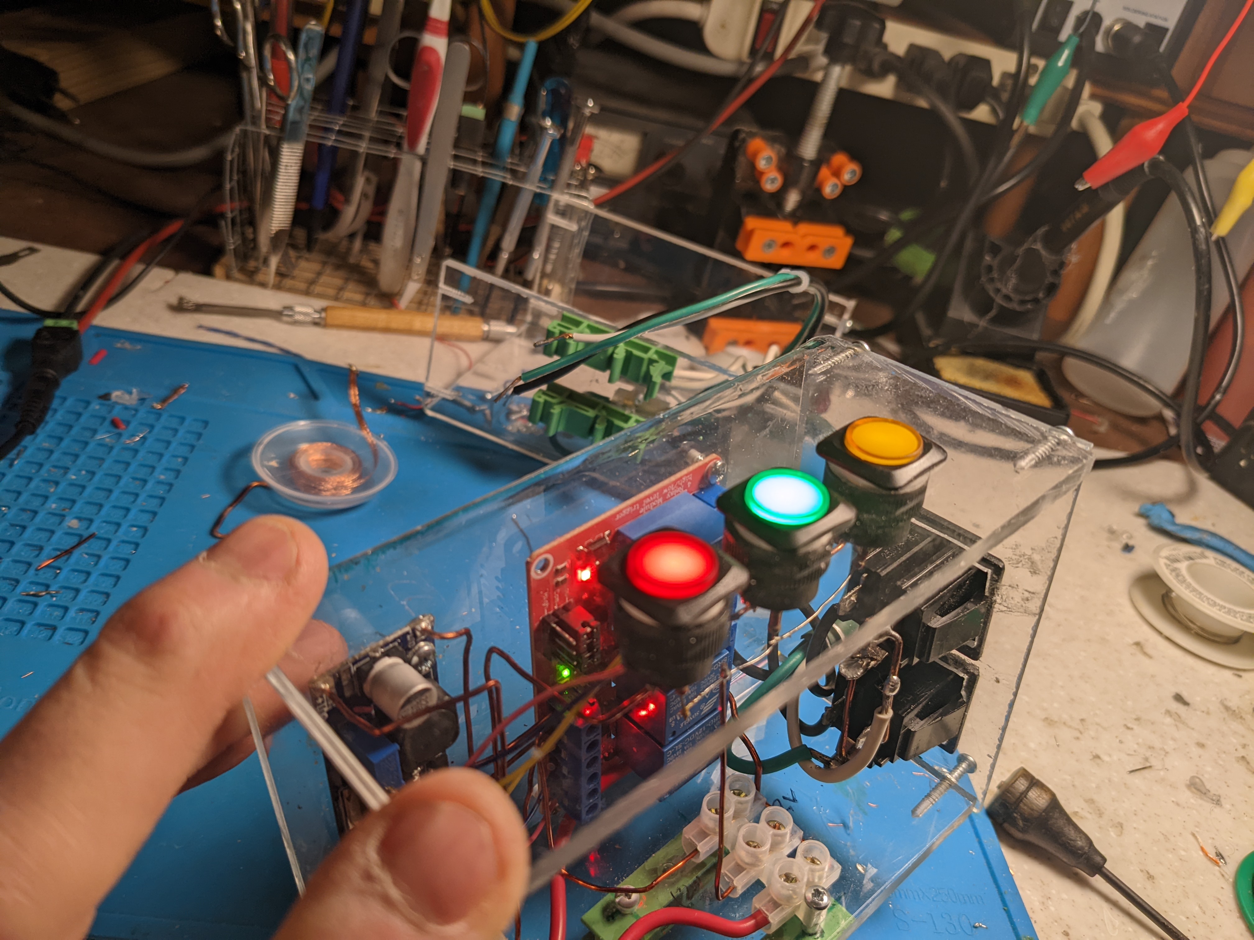

Completed the Power control module wiring.
First time ever I wired most of it using bent enameled solid copper buss wire.
Why, I thought it would be neat, rugged, and cool-looking.
