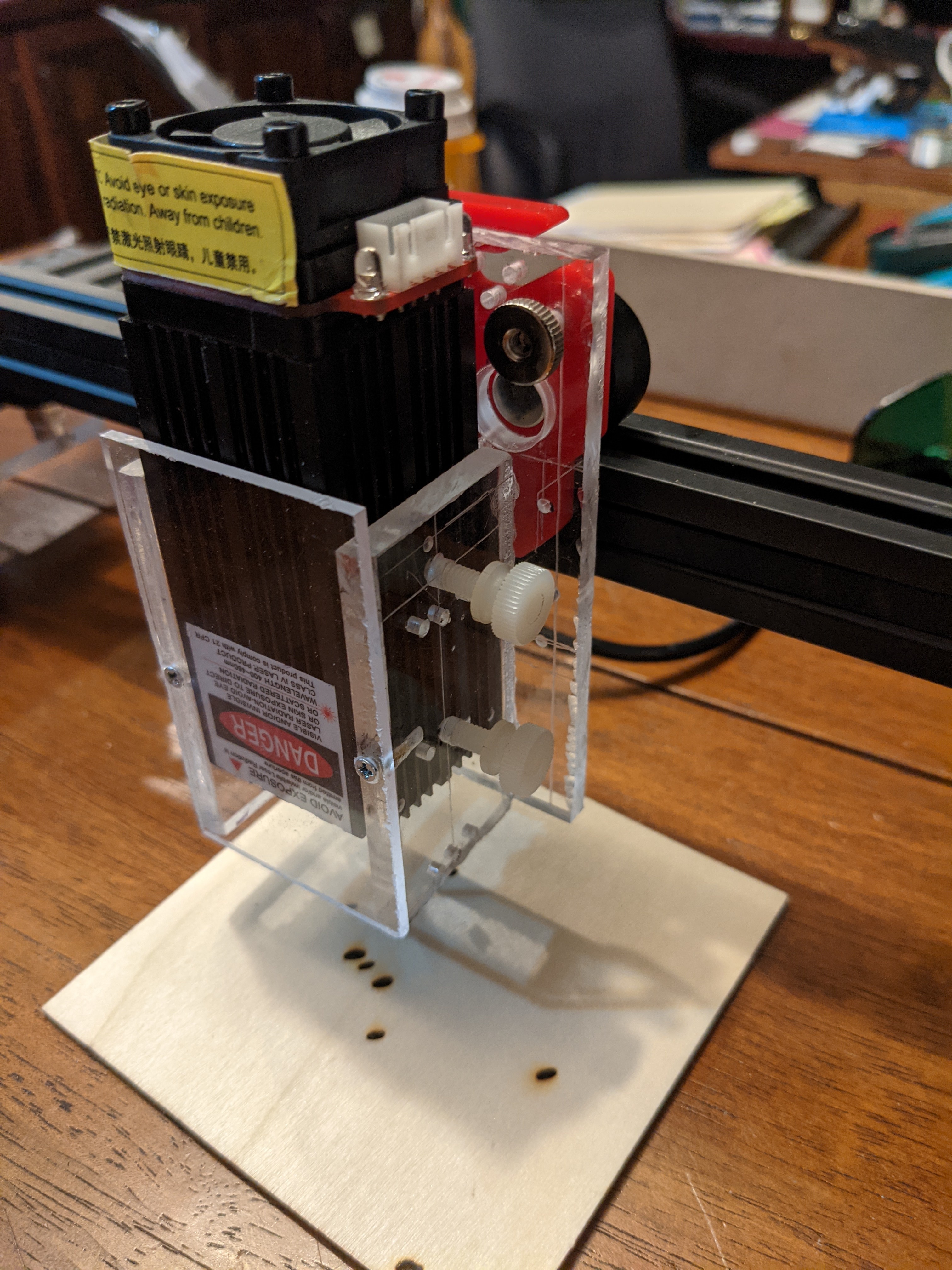

I completed the design/fab of a simple vertical adjustment laser module slide.
Adjustment Slide
Not yet knowing what’s the best way to adjust focus for my L7X I decided to build a slide that would enable simple adjustment of the diode modules vertical position.
Prototype SlideDesign
This is a simple design and concept. Replace the stock carriage interface plate with one that has a sliding channel for the diode module. The up/down motion is achieved by loosening a binding screw, sliding the laser module, and then retightening the screw.
This may be too simple for long-term use but I needed to make a fast prototype that would allow a simple yet large range of adjustment. Using this proto I will identify how much range & precision the vertical adjustment needs to have.
Once the adjustment needs are identified I may change the approach to a screw slide.

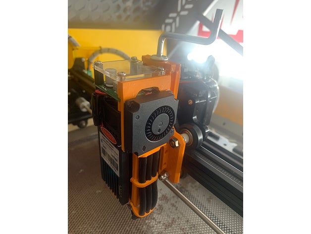

This is what I posted on and went with on my Ortur Laser Master 1 cantilever laser engraver. Love not messing with the lens adjustment any more.:
Mo info! :wink:
@dougl
Didn’t realize you had a LD machine :slight_smile:
My plan is to always engrave below the bottom of the machine.
So once the focus is set there is no more adjustment.
Is this going to be a practical strategy?
One of the first few hacks I made to the Ortur LM1 was to move some mounting screws so the cantilevered arm was about 20mm lower just so I could focus to the surface the machine was on.
I then engraved a large cardboard box in sections by just repositioning the laser machine on the box.
If you really will only use it for a single purpose then it’s not a bad strategy.
But these things will engrave lots of things which are smaller than the the machine and will have thickness within the working area so focusing is needed. I started doing slate and cork coasters recently and soon will try the Norton Method on some glass coasters. White tiles and the Norton Method of engraving is pretty amazing.

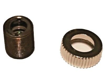

I got my lens from an ebay reseller. Looks like he’s still selling them. This is what fit my Ortur but the threads might not fit what you have so check that. This also only takes a few threads to get the focus I want so I designed a 3D printed holder which uses an o-ring to help create the friction to keep the lens from backing out.
Some people use a single lens G8 for a bit better dot shape. Not as good as the 3 element and has less optical losses but my take was that the better focus point gets you a bit more condensed power even if that power is a bit less. Make sense?
Yes makes sense…
I think (only by the manuf. beam specs) that mine is a G8.
BTW, I tripped over this, very weird size :slight_smile:
Do you think this is the same lens??
I don’t know much about optics but I wasn’t happy with the stock lens and the oval shape which made burning in the Y direction a thinner line than burning in the X direction on my machine(I might have that reversed). People were talking about switching to the G8, IIRC mine came with a G2 so I tried one and wasn’t thrilled. Somewhere along the way I read about the 3 element design giving a smaller and better shaped focal point at an optical loss of a few percentage points. Seemed to me that might be a wash if the point was smaller and better shaped. I talked with that eBay seller and he said I might like his 3 element lens so I tried it and it seemed better and I’ve been using it ever since. Because of the limited focusing number of interfaced threads I looked at some Z axis options and hacked the most commonly liked one for the Ortur Laser Master 2 machine.
