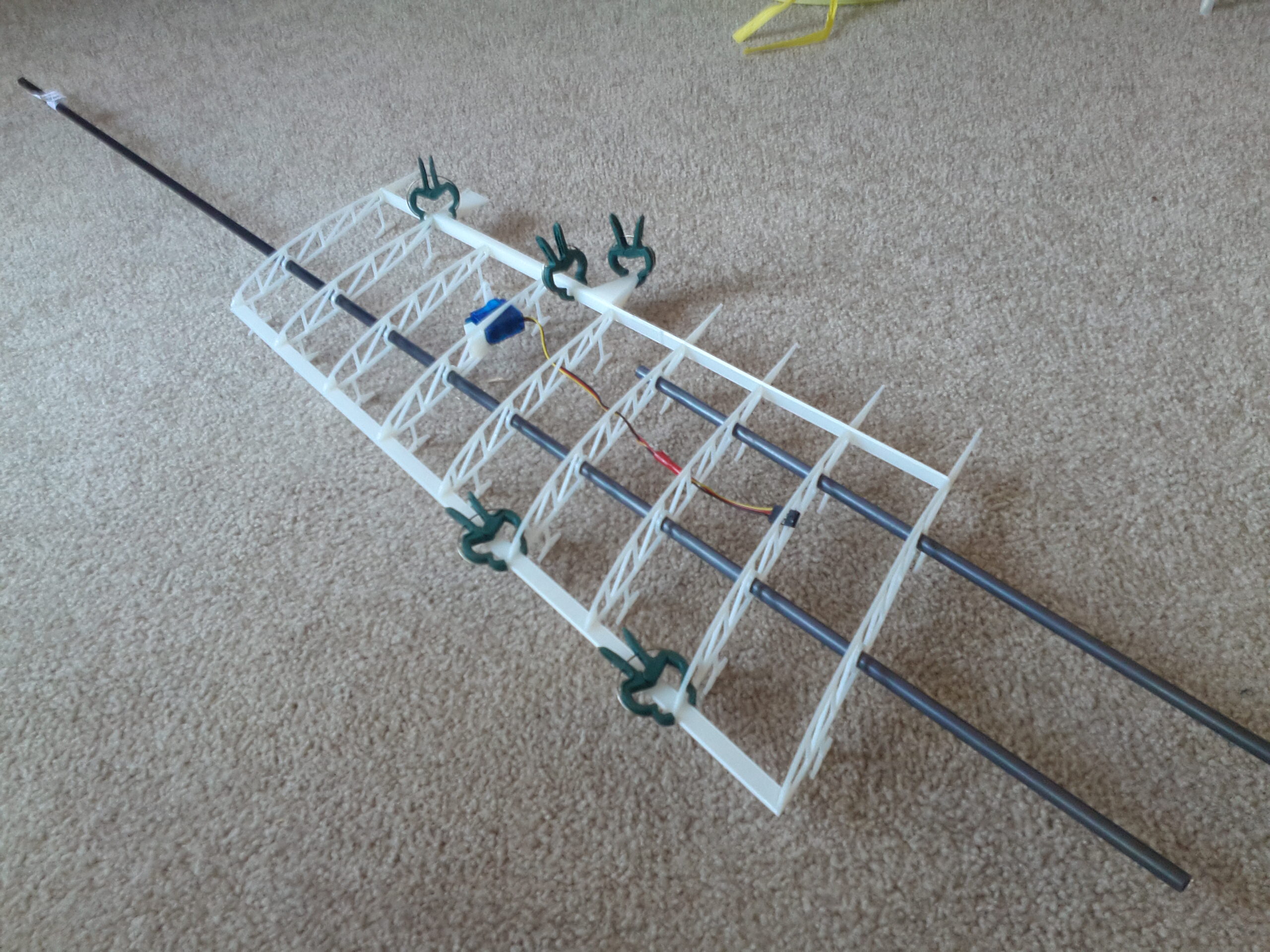

Mock up with the latest mods to the wing.
Mock up with the latest mods to the wing. Note the 9g servo mount and the second shorter spar. The wing design is ready, I’m gonna print the left one and commit the updates.
I just need to make one more mod to the fuselage and reprint and I think it’ll be ready for a V1 flight.
oh yes… I also need to make the “canopy”.
