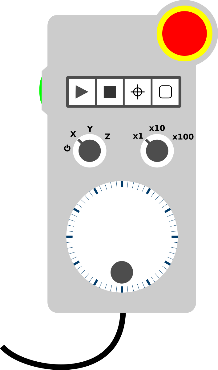

The question is, if all the other buttons should just generate keycodes for the LW4 frontend or better be fed directly to the server?
Most of the buttons will have to send commands to the machine anyways, so probably it makes more sense to connect the controller to the server, but then, what to do with the play button? The gcode resides on the frontend (or better just one of the connected frontends).

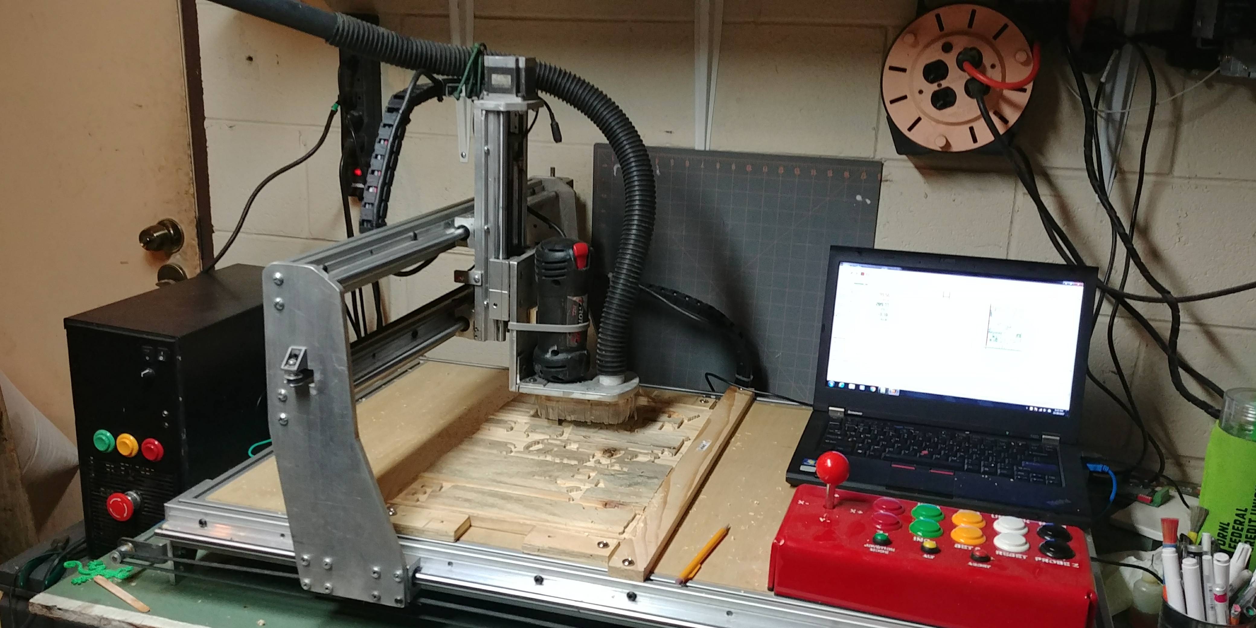

I works pretty well. I have the 4 way joystick doing the X and Y. I have two buttons for Z up and down. two buttons for + and - on the jog scale. cycles through .01mm, 1mm, 10mm, and 100mm. The other buttons I have set to “Go To Zero”, “Set Zero”, “Reset”, “Unlock”, a couple of macros. “Home” and “Probe Z”. Then I have “Pause”, “Send”, “Abort”.
I am having a lot of problems with UGS because of file size and some other annoying things. I would love to adapt my rig to work with Laserweb4 but I don’t know keyboard mappings. I see a lot of replies here saying they are in the code. Where? I’m not a coder. I have looked all through the files and can’t seem to find anything. Help?
Oh. If I were re-doing this. I would not use the joystick. Just separate buttons for X and Y +/-.
The “jog wheel” could be dangerous since the machine doesn’t keep up with each pulse, so it is easy to send to many commands at once. You then way over run. It is much better to limit button pulse to one movement. .1, 1, 10, 100, scale. You don’t even want to enable repeat. Luckily I have a belt driven system so it only slips the belt. A screw drive could do damage.
