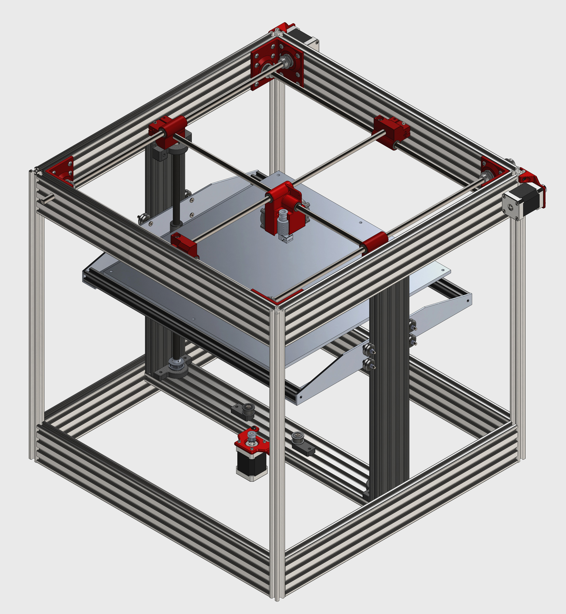

Modeling the conversion of my CoreXY to a large Eustathios/Ingentis is coming along nicely.
Uses all 10mm rod, large nema17 60mm steppers from Robotdigg. I will be redesigning the extruder carriage, but it is a placeholder for now.

That’s one stout box!
@Mike_Miller yup. It’s pretty over built
It is overbuilt for vertical resonance, but underbuilt for torsional forces. However, it is above average. I think all the ingentis/quadrap/ringrap machines are all lacking diagonal supports.

@Matt_Kraemer it gets fully enclosed. I have side lexan panels not shown. So I don’t think it’ll be an issue. It wasn’t on the CoreXY.
