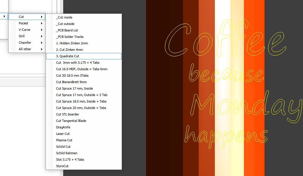

Unfortunately, even with 4-axis machines I seem unable to select projection on STL cuts. It isn’t present in the cut menu, even when I have the 2D object positioned as indicated in the feature youtube videos.
And here is the Cut menu, with no projection option. This is a 4 axis machine, just for testing.
I see. So its more a question of the software capability. Sorry, I will not be able to assist. I am the most ignorant person on here for cam software. Hopefully someone can help on here. They are super smart.

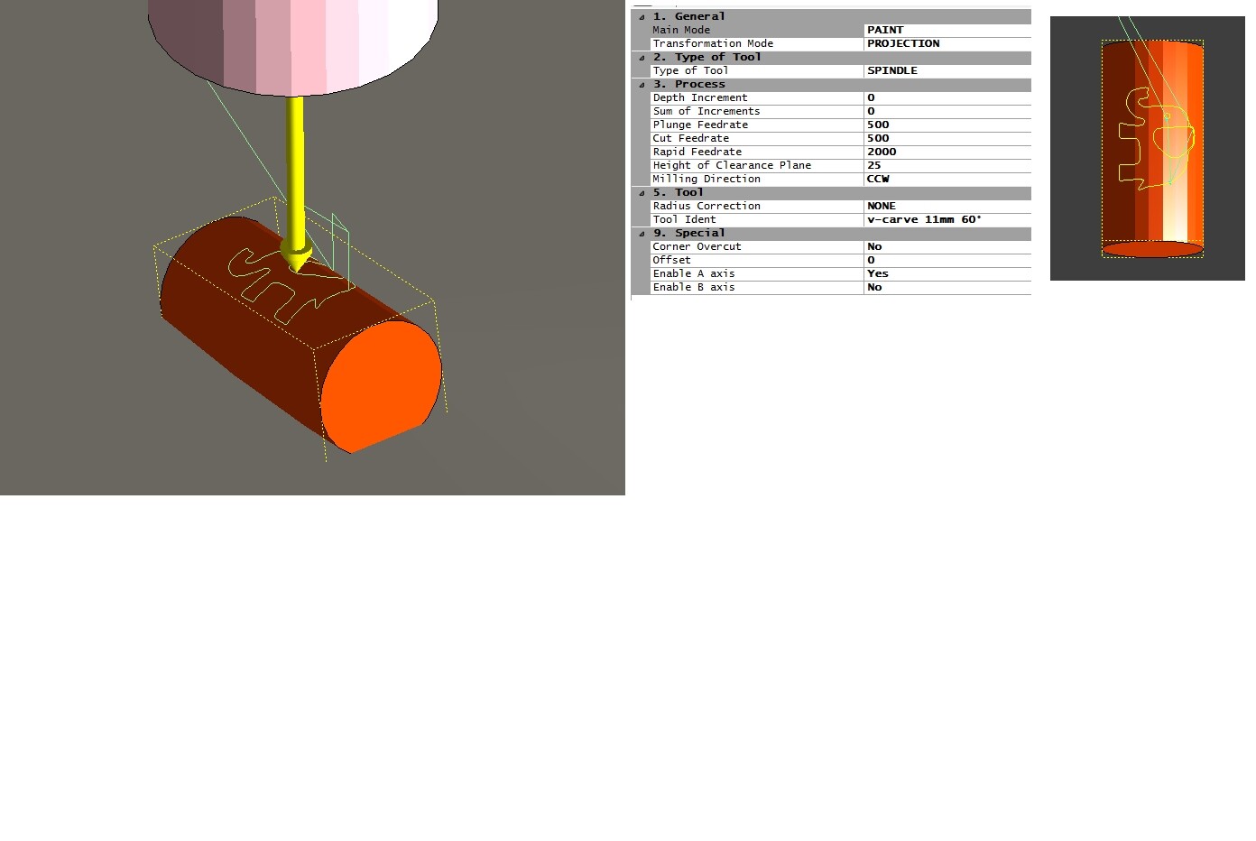

If I understood your question correctly, you want to project the DXF drawing onto the side of the STL.
The projection is always from top to bottom, i.e. in Z-direction. But you can change the position of the STL.
Press CTRL AND the left mouse button to select the STL. The STL gets a dashed frame.
Now you can open the 3D Context Menu with CTRL AND a right mouse click. Select ‘Geometry Editor’ and rotate the object with e.g. delta x to rotate the object by 90°.
Now position the tool in the 3D view approximately above the STL and press “Set Workpiece Zero Point”.
Go to the 2D view and select the paths of your drawing. Press the right mouse button (without CTRL) to open the 2D context menu. Select ‘Graphic Editor’ and position your DXF exactly over your STL. Now create a job “Paint + PROJECTION”.

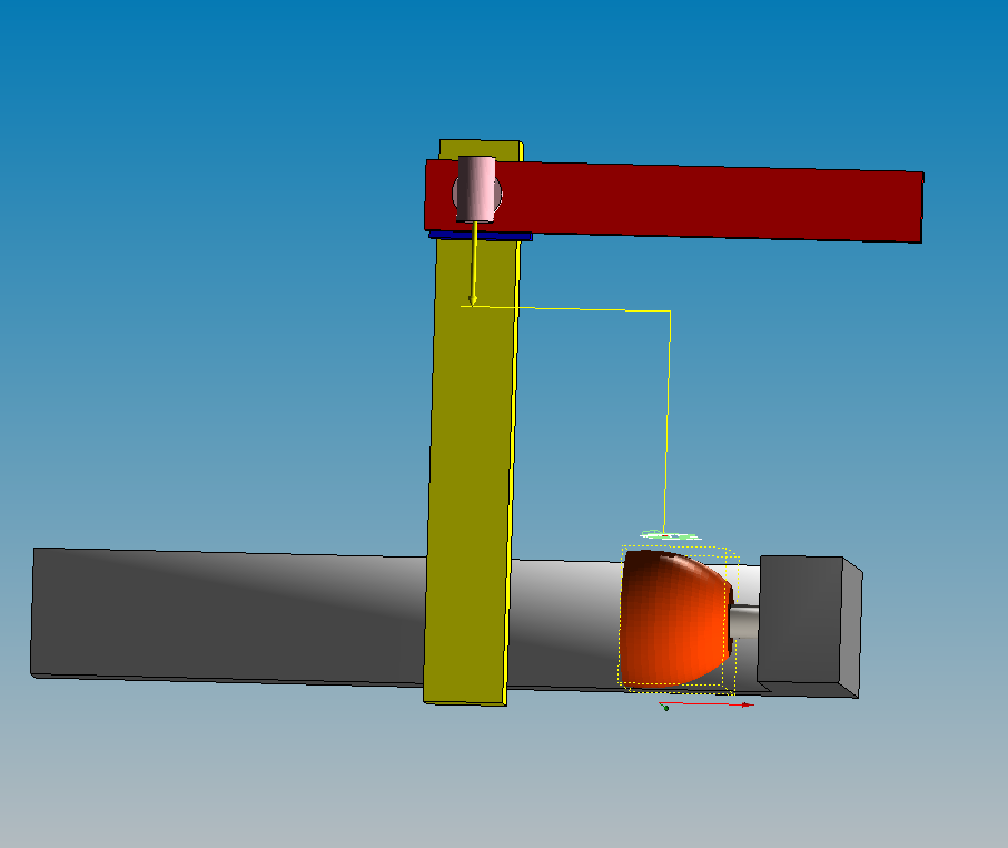

The machine I am trying to build is effectively a “bolt-on” 5-axis for my wood lathe. A axis is the lathe spindle, with an X, Z, and tools on a B axis. I have been able to get it to work to some extent, starting with the DIYCNC-Engraver and doing some very basic stl mock ups. In my case the tool (B axis) would physically be mounted on the X axis, but I’ve found that GG defaults to putting tools on Z, so it doesn’t look pretty, but works:
With this setup I have been able to get A and B axes working, though because my A axis setting is X=-1, any projections are inverted:
I suppose this is related to how the coordinate axes are established in the machine definition.
I’ve also played around with trying to do cylinder projects and that leads to tool paths being placed at weird locations (that are not impacted by radius setting of the stock). I haven’t probed around much with that yet.
