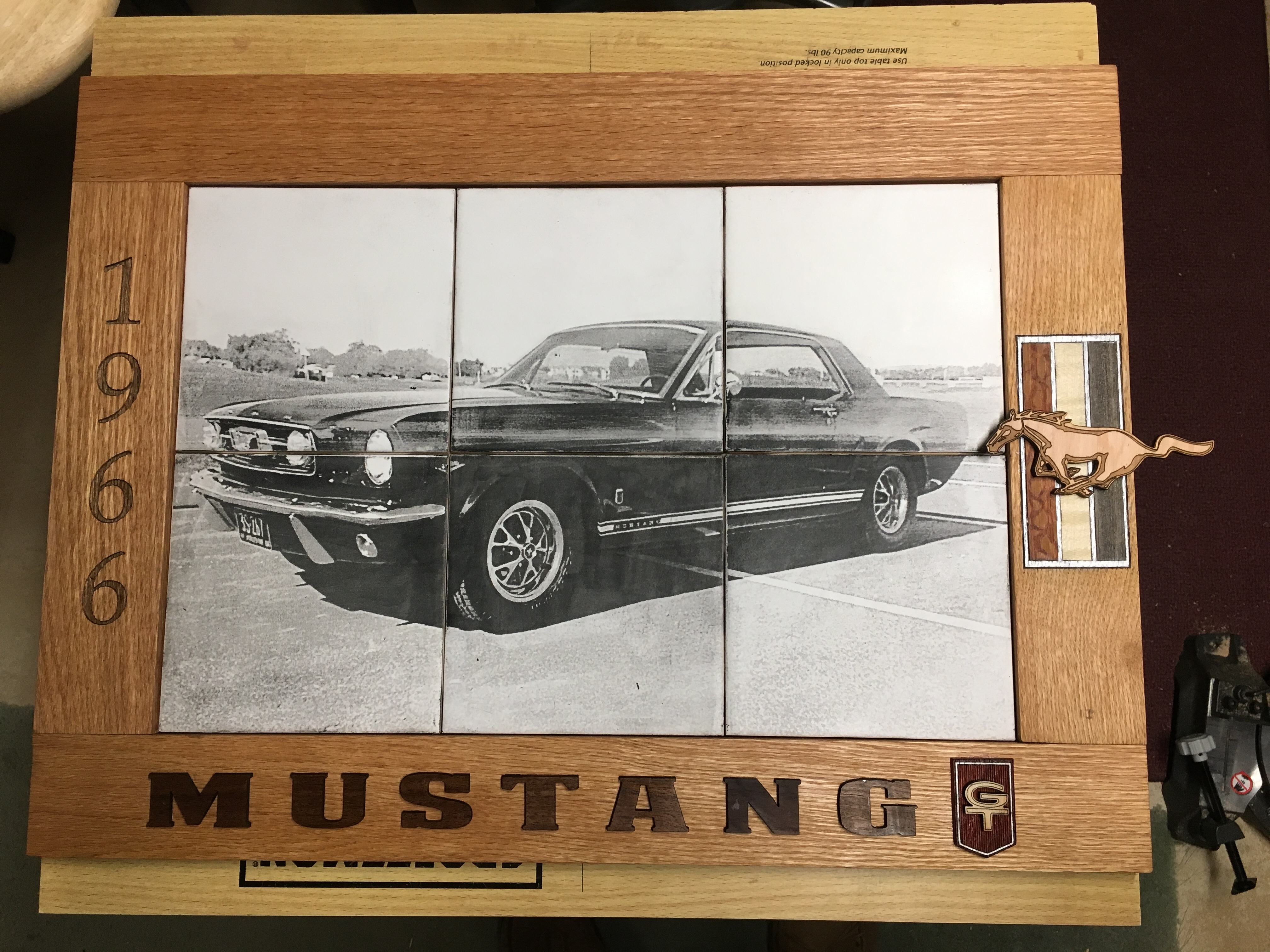

I wanted something large, but was limited by the bed size of the k40, these tiles are 6x6 matte finish.
