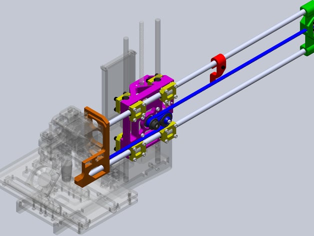

I used this for Y axis:
and this for X axis, using the original (wood) bed:
Since I used the original bed, I got the 140mm in the X axis, and the full 100mm in the Y axis.
I may add a different bed later to increase this further (the rods I used have extra length for both axes).
