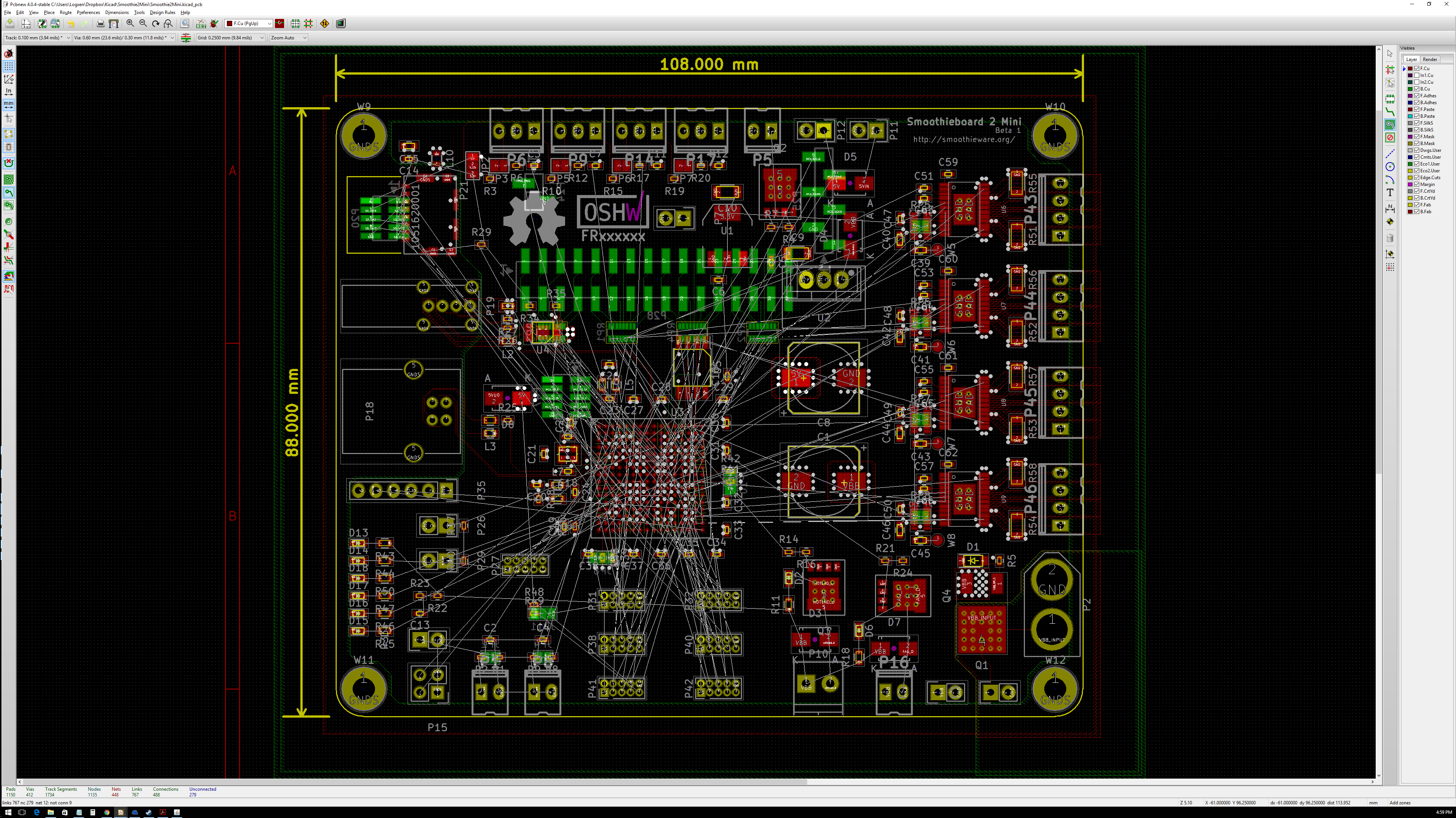

More progress on the Smoothieboard v2-mini-alpha design.
Is the v2 going to have a more powerful/faster ARM CPU than v1?
I’m not Arthur and I don’t play him on TV :slight_smile: but I can answer this.
Yeah, Smoothie v2 is upgrading to a Cortex M4 with M0 coprocessor for step generation. Current Smoothie v1 uses a Cortex M3. Our M3’s run at 120MHZ and the M4’s are in the 200MHZ range, don’t know the exact value off the top of my head.
LOL! Thanks @raykholo . :slight_smile:
204 Mhz, 264kB ram, 8MB flash, FPU. The board will also have higher microstepping.
That’s just the v2-mini.
The v2 itself will have even better drivers, improved safety features, higher current capacity, and a lot of goodies.
And the v2-pro will have even better everything on top of that, plus a FPGA.
