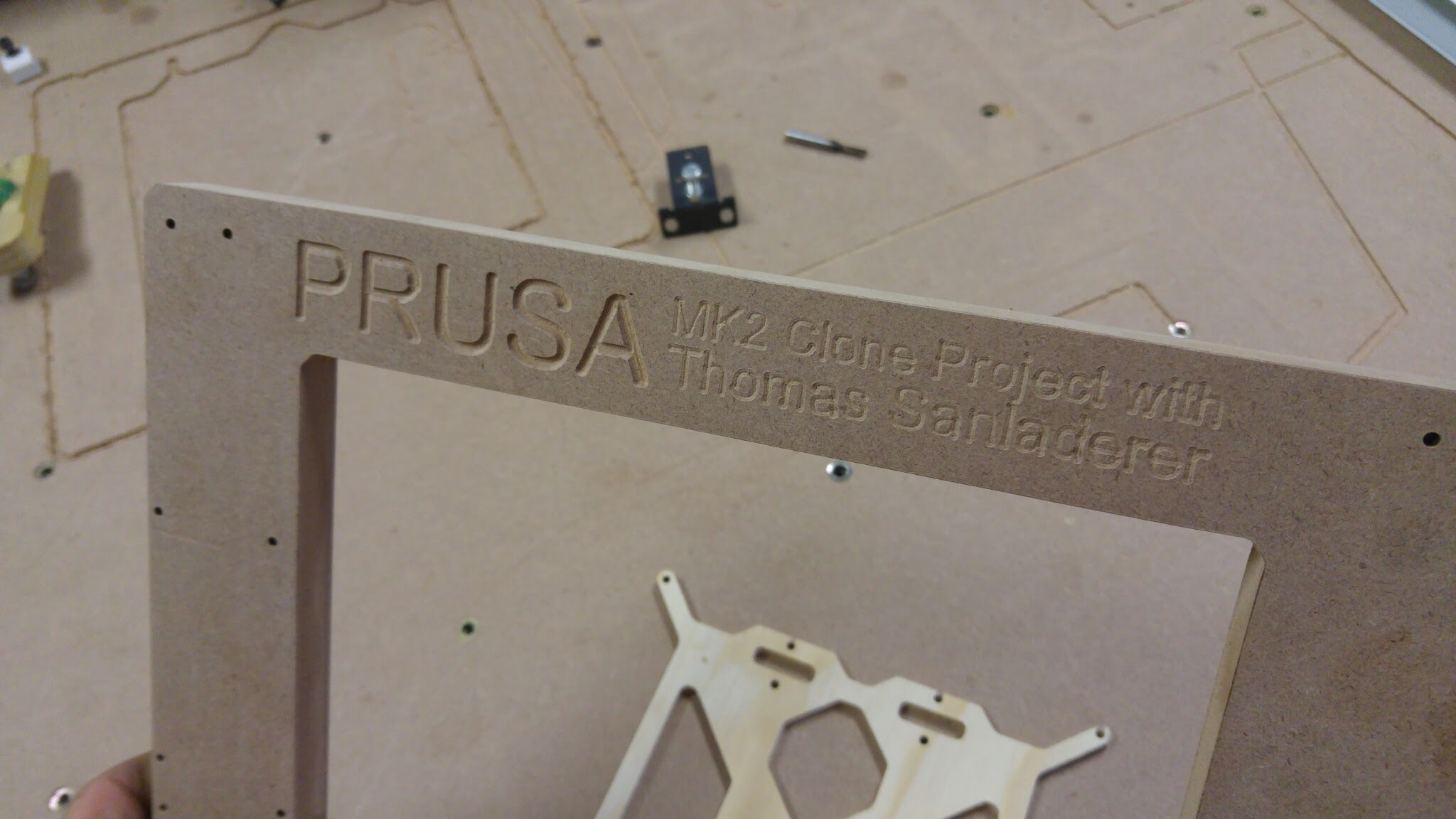

Great vid- it has me jonesing to get my cheap 6040 Chinese CNC up and running on LinuxCNC again- either way to make the frame and carriage is a fun and constructive engineering lesson and great to learn.
Here’s the frame I’m cutting. doing mine with F360 but importantly I had to open it in Inkscape and save as an SVG to get the size right. Then just click and extrude. Oh and a little bit of text. ;-p

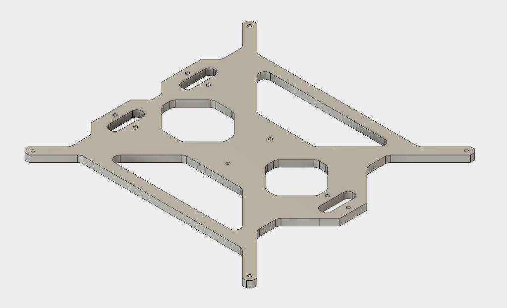

The carriage I did actually change a little. I added 5mm radius to the inside corners just to make is easier to cut. I’m happy to share it.

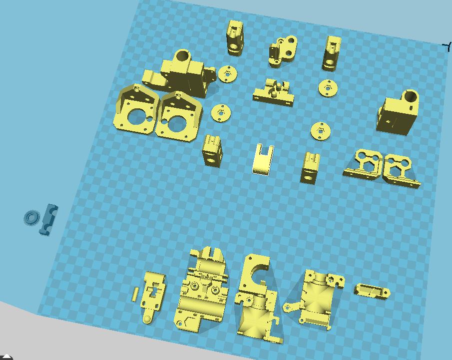

the printed parts needed ( having never built one of these ) Im not all that keen on not building along because I missed a part. I know I don’t need to print some of the parts. LCD covers if I already have or will use a different one. So is that a picture of maybe a buildplate with the needed parts and quantities only.
Parts I cant place are like the Y-distance.stl does it need 1 or 4 of them. The spool holder wont fit on a 18mm frame so no point printing that now. I did a layout of what I think is needed and a general layout of where. ( i wont actually print them like that, but yes that is the actual bed size of one of my machines. ) the parts off the plate on the side are the ones I don’t know where they go or how many I need.
