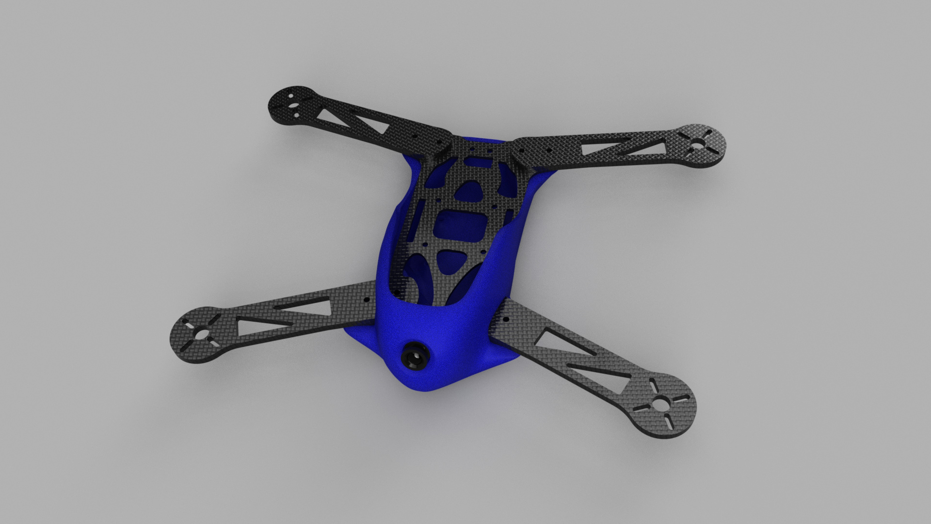

More suggestions for improvement?
Haha maybe name it “OpenRaceCopter” :smiley:
more holes, for easing customizing?
Slot the second hole on the legs in an arch for more adjustment to weight distribution
Front arms one piece, back arms one piece. Only 2 screws needed.
@Fabian_Schurig This is awesome. Are you putting this design on thingiverse?
@bcrazycramer
Yes, I will upload my source files, too. But first I need to improve it, add additional suggestions I collected and then produce at least one to test it.
@Fabian_Schurig I’m looking to print the hull here in a bit, if you want me to beta print the arms I can give it a try. :slight_smile:
Nice work. I’m enjoying following your progress. What CAD tool are you using? What are you using to 3D render?
I am using Autodesk Fusion 360 for both, modeling and rendering.
If you included a variable-angle mount in the hull for the board camera, it would be a good quad for learning to fly.
