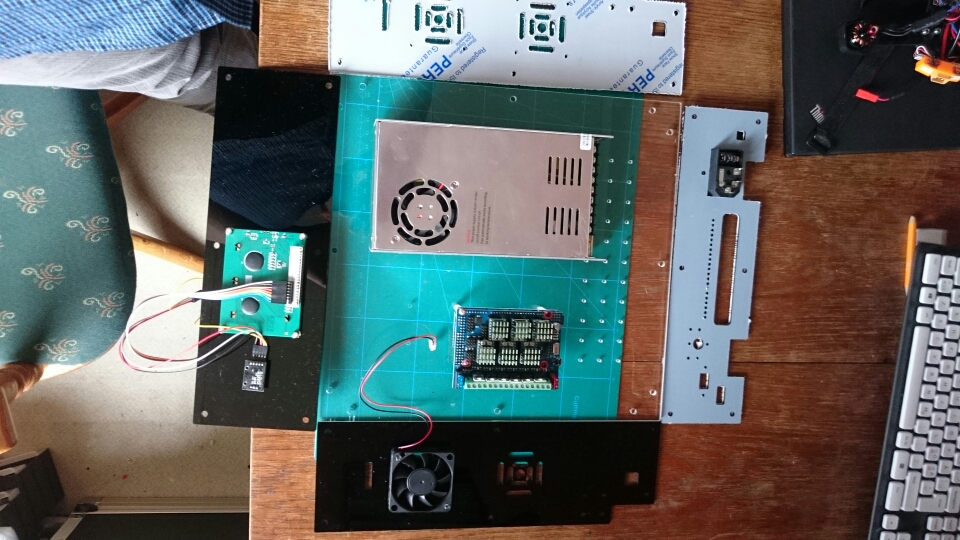

More updates about my OrdBox build.
More updates about my OrdBox build. All panels is as planned in the 3D model. Now I have to wait until the alu profiles arrive.
In this test, I`m using 5mm clear acrylic on top and bottom - the rest is 3mm black acrylic.
My OrdBot is blue, so I do not get the all black that I used in the 3D model.
May I ask, what you are using 6 stepperdrivers for?
I`m going to use this printer while testing the Diamond 3in1 nozzle
StepperDrivers:
X, Y and Z
3 x extruders
If I want, I can add an extension board to RADDS and get two more drivers - if I do that I can use dual Z-Drivers = 7 stepper drivers - but I`ll use 6 on this setup
http://reprap.me/diamond-hotend.html
some more info at my site (http://www.mundsen.no) but in Norwegian
I am asking, cause I learned the hard way to put in the fewest drivers possible at the beginning :smiley: Killed 5 drivers instant, could have been just 2… RAPS128 aren’t that cheap :slight_smile:
The frame and carriage do make Ord a good platform for building custom extruders.
