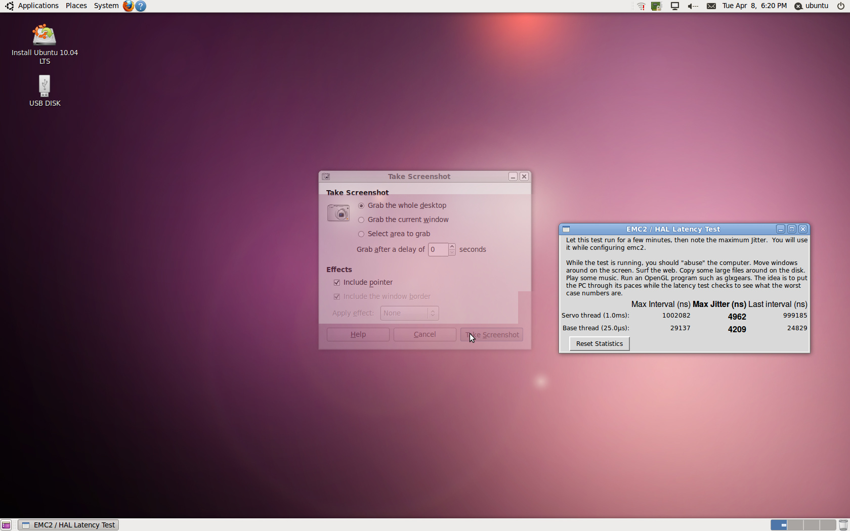

Motherboard arrived today, and after a hiccup with the power supply,
Motherboard arrived today, and after a hiccup with the power supply, it’s up and running. LinuxCNC 10.04 dual boot installed and running fine. From this point I will speak Linux: heY who do there feet man Ç glUe thing bee loot who the what see balls¡¿

Was just playing around with it. Looking at the different programs and busying the system for the latency test. Decided I needed to see the cpu temp n fan speed. So I “clicked” on the ubuntu software center. It showed that a program called fancontrol was already installed. So I look, n look, n look some more. No where to be found. Found a directory (or dose linux use a diff word for that too). No luck running it. Even installed a second program, same thing except I’ve yet to find it’s directory.
