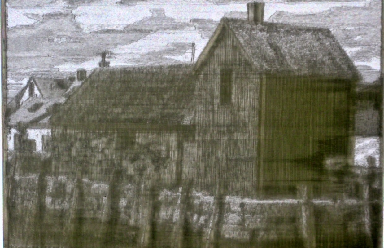

Motif #1 Lithophane added to YouMagine https://www.youmagine.com/designs/motif-1-lithophane
