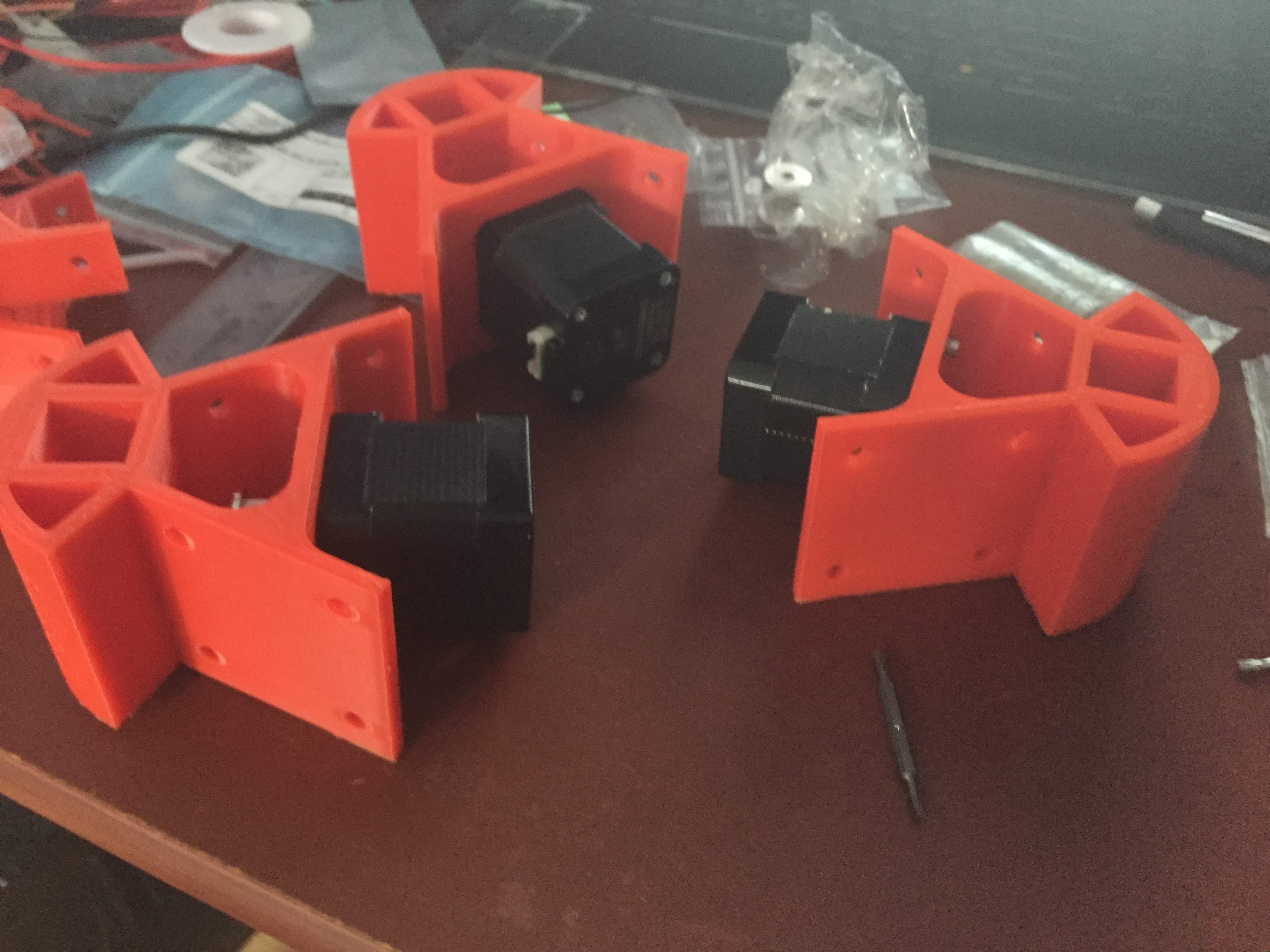

Mounting the motors took an hour that I'll never get back.
Mounting the motors took an hour that I’ll never get back. Why no wrench access holes?
Yep I had that problem with the original kossel printted parts. Finally I cut a Allen key to tighten that screws

You could always drill a hole, it shouldn’t compromise integrity too much. Or just open it up in Netfabb and boolean cut a hole.
The official kossel mini vertices definitely have allen wrench access grooves. Those don’t look official.
Vslot Mini Kossel variant from Ultibots.
Will definitely verify this if I build another delta.
