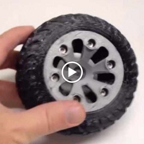

Movie on the new rim and tire turned out to be a nice combo.
Movie on the new #3dprinted rim and tire turned out to be a nice combo. Also made the tire wall thinner under the pattern and its much softer now and will be great on the car me thinks… Check it out: Tire: http://www.thingiverse.com/download:896048
All files: Set of wheels for OpenRC Truggy by Palmiga - Thingiverse
what material are you using for the tire?
TPU 85 Shore A ( http://www.creativetools.se/Filament/filament-175_se/TPE/eco-tpu-85a-1-75mm-svart-1kg-se ) and I of cource tried my own conductive TPU, but that material is way too hard at 95 Shore A ( http://www.creativetools.se/pi-etpu-95-250-carbon-black-1kg-se )
