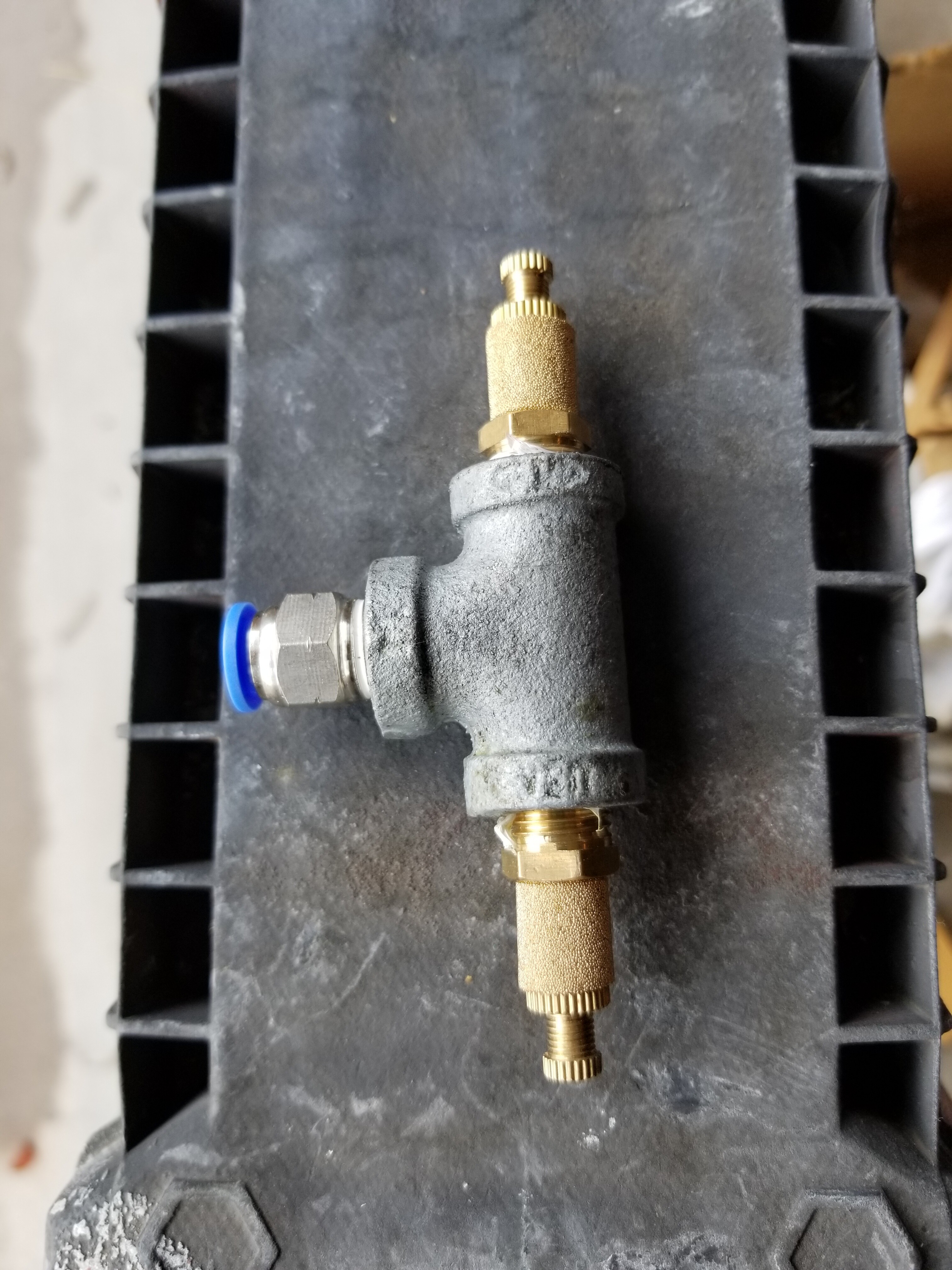

I finally resolved to use a 1/4 galvanized pipe T… worked well… but I have a few of the mufflers left…
This manifold is close to what I was looking for…
It’s a manifold for ‘air brushes’, so it has a maximum pressure of 1MPa (about 145 psi). My compressor upper limit is 175 lbs, but since there is not much resistance, I doubt it will be an issue. Just be aware.
Ended up with this…
The bottom connector is also from Amazon…
Hopefully this will help others with this issue save their dogs, ears, or maybe both.
