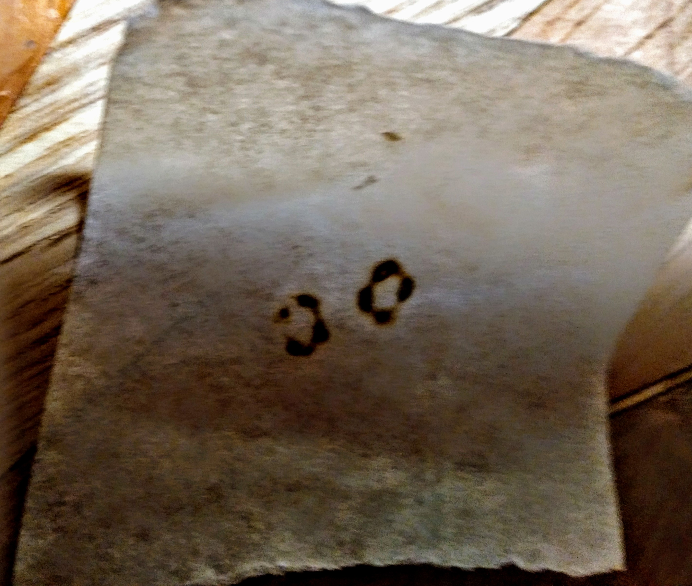

The two beam shots are on the left mirror 2 and on the right mirror 1 straight out of the tube. Any thoughts? Could it be dirt in the end of the laser tube?
Your tube has shifted to a higher Transverse Electromagnetic Mode (TEM). Looks like the TEM02 pattern. Nothing to do but get a new tube I’m afraid.
Less than a month oldā˜¹ļø Thanks for the advice though. How could that have happenedšŸ¤”
Tubes can go bad quick if there is no or insufficient cooling. Or it’s possible it was just a bad / marginal tube to start with.
