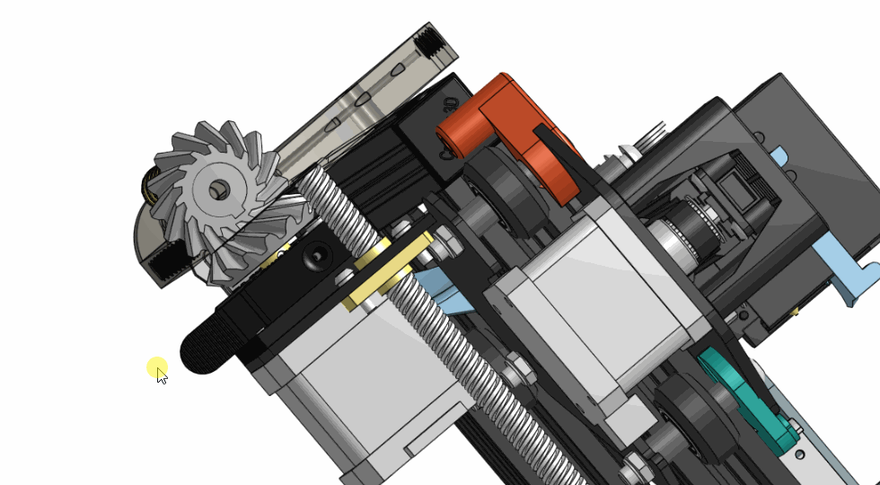

multi color meccanical switching for ender 3, ready to print and test after my xmas hollidays
What’s with the bevel gears? Printing those or buying them?
@Ryan_Carlyle print but are real item too
Why use them versus direct drive? Or a worm gear or something to improve torque?

Your bowden tube is going to collide with itself.
I designed those to exit the extruder sideways for a reason. The 270 degree bend beginning parallel to the axis allows for a short tube that will not undergo a significant change in its overall curvature as it travels a relatively long distance. Other configurations require a longer tube to avoid kinking.
Btw, I’m also doubtful about the switching mechanism. That grooved idler is not going to slide easily from one filament to the next. How are you planning on actuating it? I see something sticking off of the carriage, but how does it grab the idler and release it in the desired position? Looks to me like you’re just begging for skipped steps in the x axis.
Same i thinking but want try in case use 6six way splitter just tested and used by prusa too.
Oh and those bevel gears will only be engaged when the machine is at maximum Z. How are you planning to run the extruder the rest of the time?
