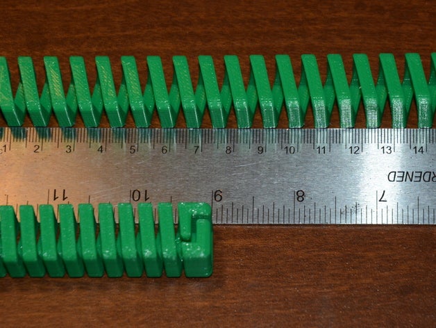

Yeah, I figured ABS would be too compliant. I’ve actually started tinkering around with PLA springs, and have been pretty pleased with the results so far.

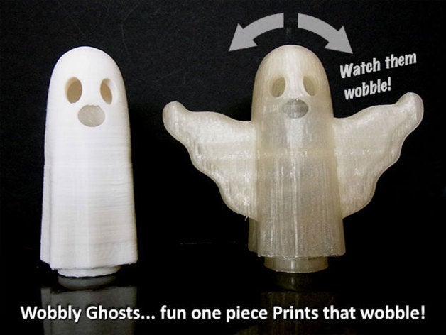

@Patrick_Ryan Here’s a fun demonstration of a PLA spring in operation:
What I learned from printing the above is that the spring does gradually give way if kept compressed – so the ghost’s wobbleability reduces over time and you eventually have to give it a stretch to get things working again (at least for ColorFabb GLOWFILL).

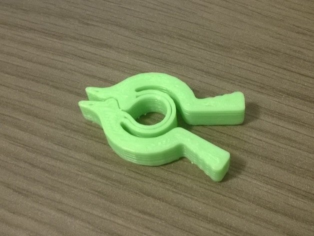

@Mark_Wheadon Fun! Here’s one I designed, not as a “spring” as such, but springiness is definitely key:
