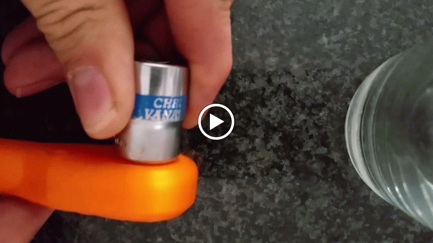

My 3D Printed toolbox is growing.
My 3D Printed toolbox is growing. Both work as they should
Good
Good functional print. Now time for different sizes of Allen screwdrivers?
What were your shell/infill/temp/etc settings on the NASA wrench? I printed one, but it didn’t actually work…
I have a bucket full of one that didn’t work and printed the working one again to make sure it wasn’t a fluke. I slowed the print to about 60% of where my printer prints nicely at that speed 0.1mm layers and under extruded a bit. 25% infill, Print time was about 6 hours.
Okay, thanks. I will try again.
