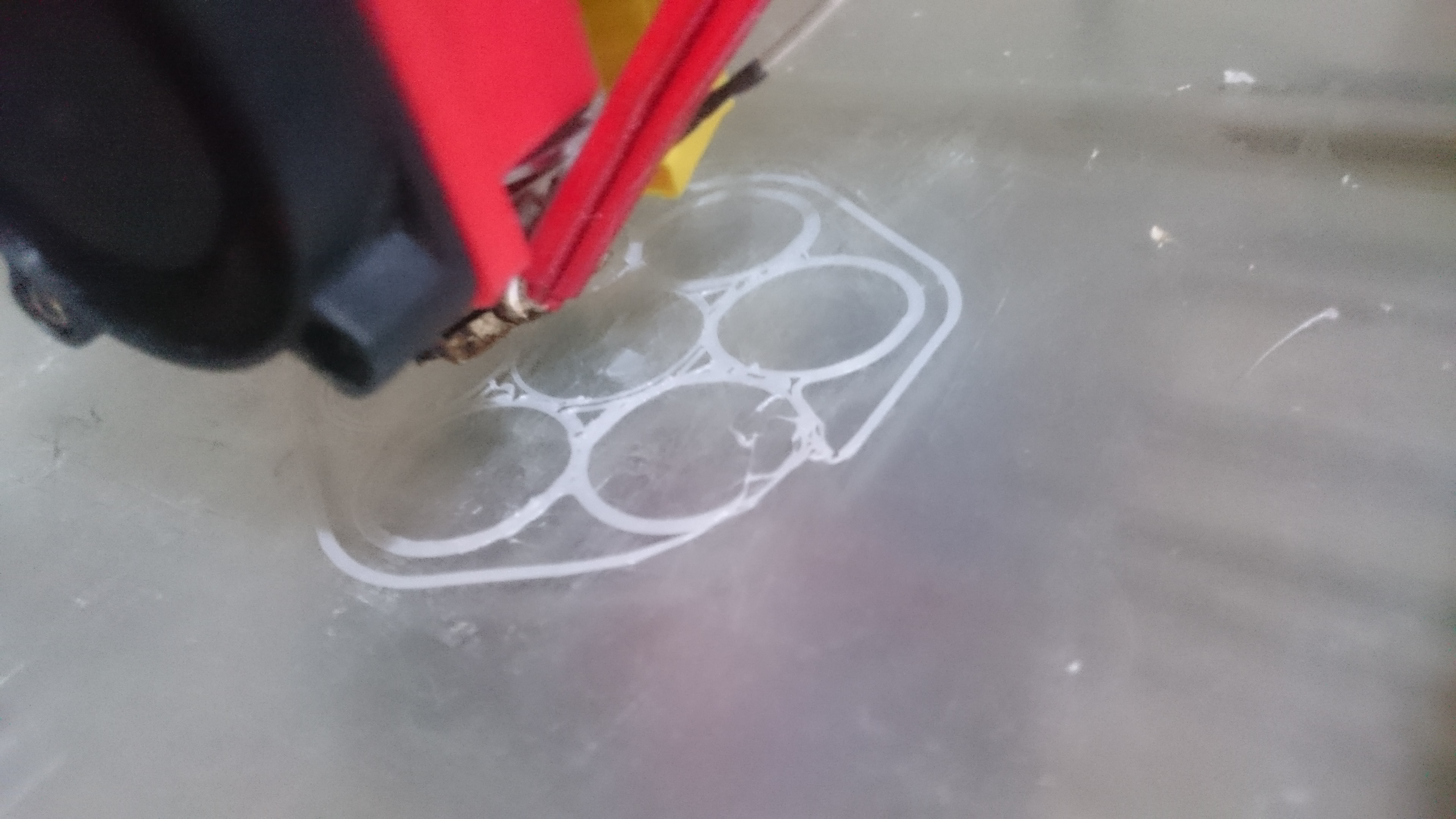

My 3d printer suddently doesn’t print circular object correctly can anyone help with it?? Every circular objects that i print seems like "oval" fyi my printer is XY configuration and i already retention the belt and still no hope

On the picture I can see that extruder push too much filament. Calibrate extruder E. Also calibrate filament diameter before every print. I use micrometer screw to measure diameter. Diameter from different factory can ocsilate from 1.69mm to 1.83mm which is over 7%. This is very important to put valid diameter in slicer.

New update i have re-calibrate my 3d printer but… Its still not good as i hope… As you can see the circle still not a circle :")
