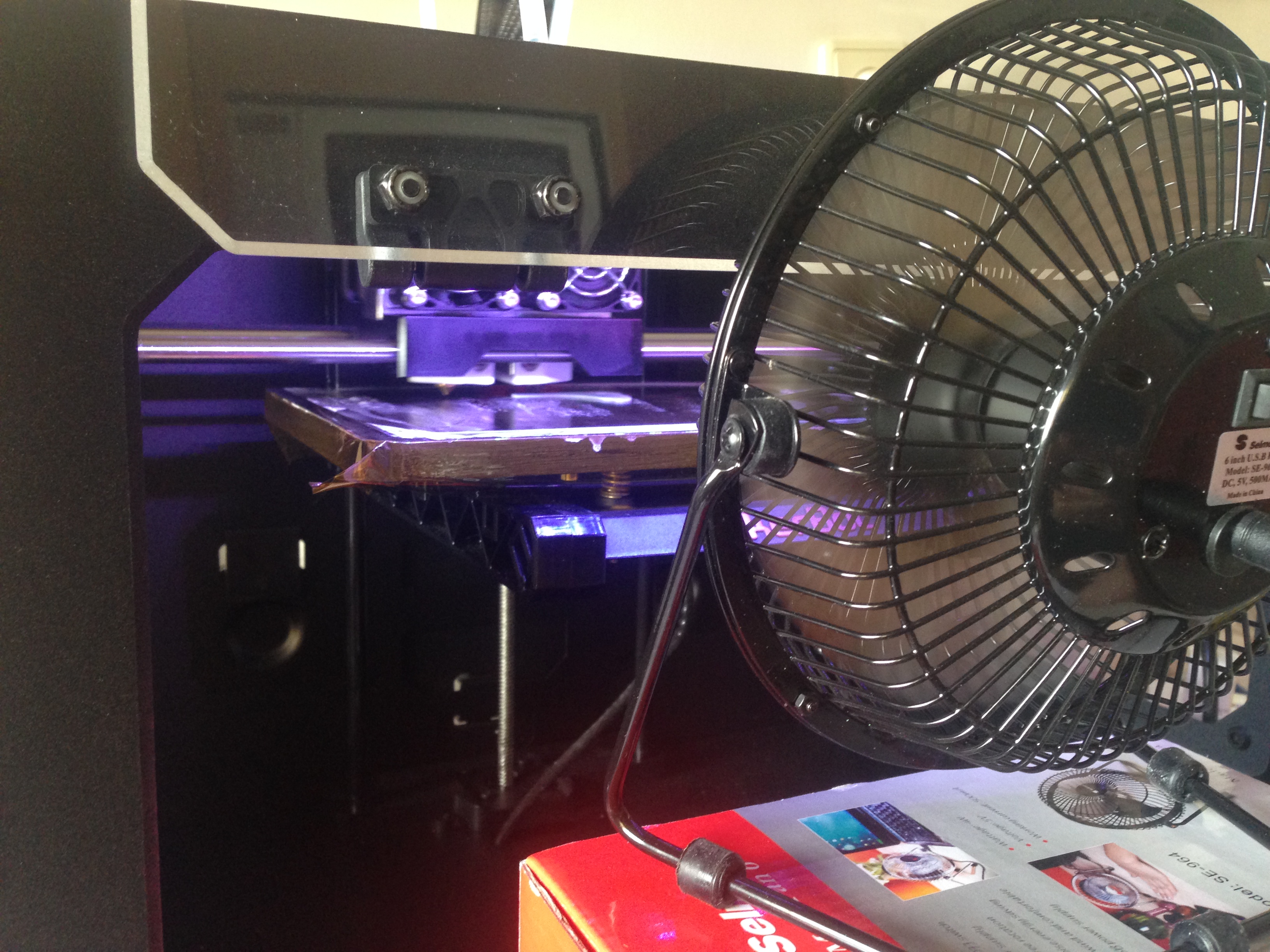

My active cooling. I found this being very effective in reducing warpage and curling
My active cooling. I found this being very effective in reducing warpage and curling when coupled with “ABS juice” and heated bed set to 80C.
I’ve always heard you don’t want to cool ABS
@Mike_Kelly_Mike_Make I also heard this, but I think that the main thing here is to keep the part with as uniform temperature as possible. You can try to keep it warm, but even with closed chamber I could not succeed. I tried to cool it and got the most amazing prints. For small prints you can also lower the speed and decrease density for better uniform cooling.
I thought that if you over-cool ABS the result can appear to be a good print, but it’s going to delaminate soon as the layers doesn’t stuck very well between them. Can you prove it wrong?
@Samuel_Ureta I did not notice any clue to this in my prints (they look very solid to me). I print with this technique only several month though, I wonder how long do you have to wait to notice that?
