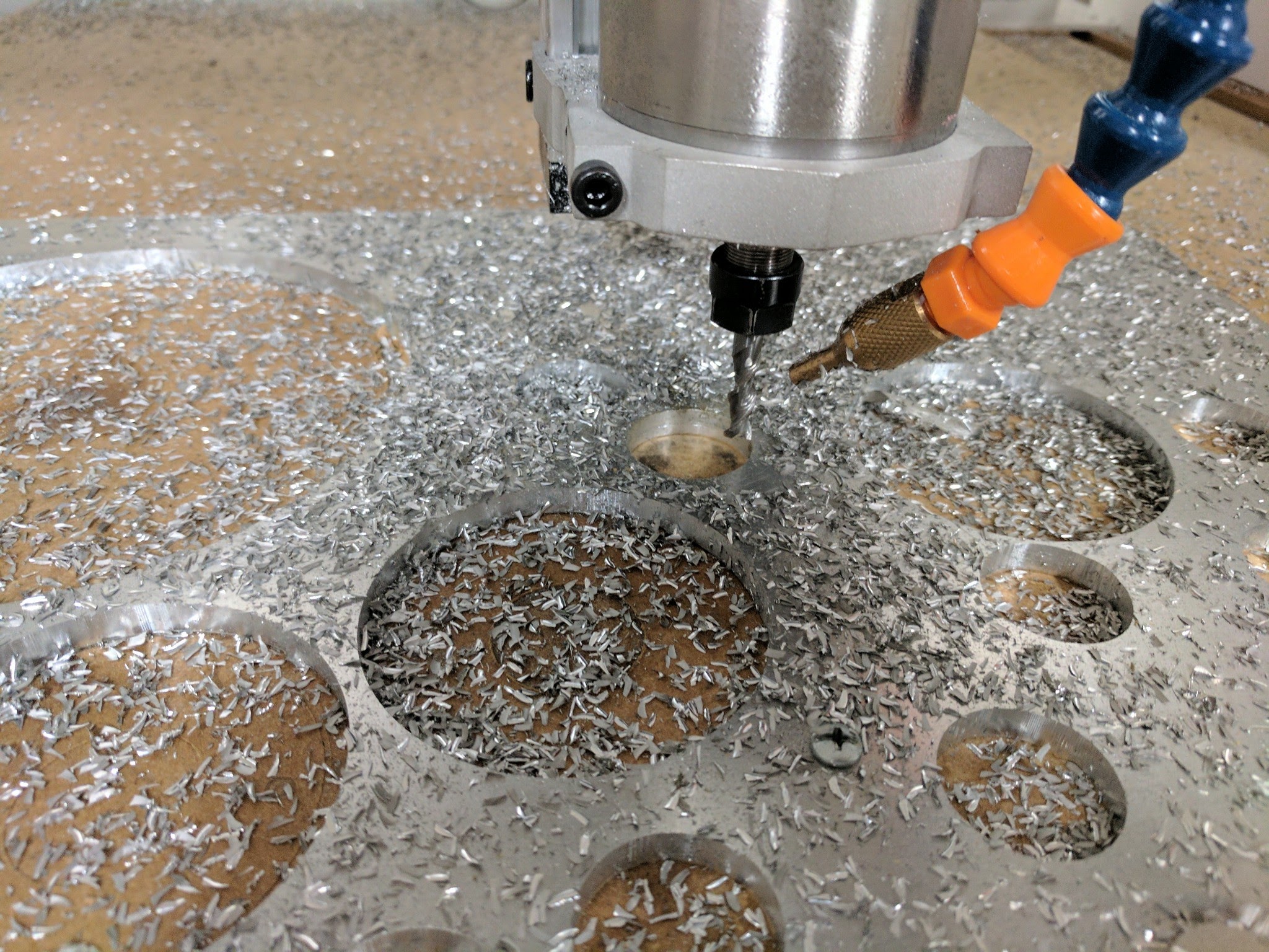

I have managed some success with the 4mm bit using conventional milling and a healthy dose of WD-40. With this setup I have been able to comfortably, accurately and reliably cut at 0.5mm DOC 500mm/min without any issues and producing flawless mirrored cuts.
So…of course, i cannot leave well enough alone. I have a LOT of aluminum to cut so I decided to try a 1/4" 2 Flute bit. GWizard declared 16090 RPM at a feedrate of over 2000mm/min. Crazy thought I, but, I thought, what the hell, gave it a shot.
Cuts came out pretty good! But it was spitting chips out that were hot enough to burn, and I think it may have been dusting any chips it was recutting, or vaporizing the WD-40, not sure which. In any case I don’t think I’ll do that again.

Congrats, pour yourself a bug glass of wd-40 and watch it cut. My own experience is 2 fluke end Mills work nice with aluminum. 1 fluke may grab in the corners and pull the cutter off path.

I can’t comment much on the single flute 1/4. It seems that you would need to slow your speed down quite a bit since you would have a greater material removal rate (compared to 4mm). I have ran into issues recutting chips that are stuck/hidden in corners and hand the tool get gummed up. What kind of aluminum are you cutting?
I do think you might be on to something though using 1/4"… It may evacuate the chips better than my favorite two flute 1/8". I have always thought a system that misted right at the tool tip, and blew a stream of air directly ahead of the cutter would be the best route

@Brandon_Satterfield ​ main reason to move to 1/4" is that I have 9x 3/4" deep pockets I need to cut so I figure 1/4" will make that easier with lower deflection. Also I have a LOT of cutting to do and not much time to do it in and if 1/4" let’s me go faster then that’ll help a lot.
I have used conventional routers on aluminum for long time. I like 2 flute 1/4" cutters with soapy water as a lubricant. You can flood the cut to control the heat and there is no smell. You have to build a system to recirculate and filter the cutting fluid however. I take big cuts and slow feeds. 1/4 x 1/4 cut at .5" per second or a little slower feels about right when routing by hand.

This was 1/4" 45 helix 2 flute bit. 1/8" doc at 254mm/min. 10k rpm. It cut. But it wasn’t too happy about it. The chip size is huge though and I think much better for it, it wasn’t burning my arms or smoking the kerosebe in the WD-40. Sure didn’t sound good though and definitely some chatter.
I haven’t cut any aluminum for a couple months, but there is still aluminum chips everywhere. They never seem to go away. I will say those chips are pretty large. How long are your tools lasting you? Oh, and I’m curious… What are you making?

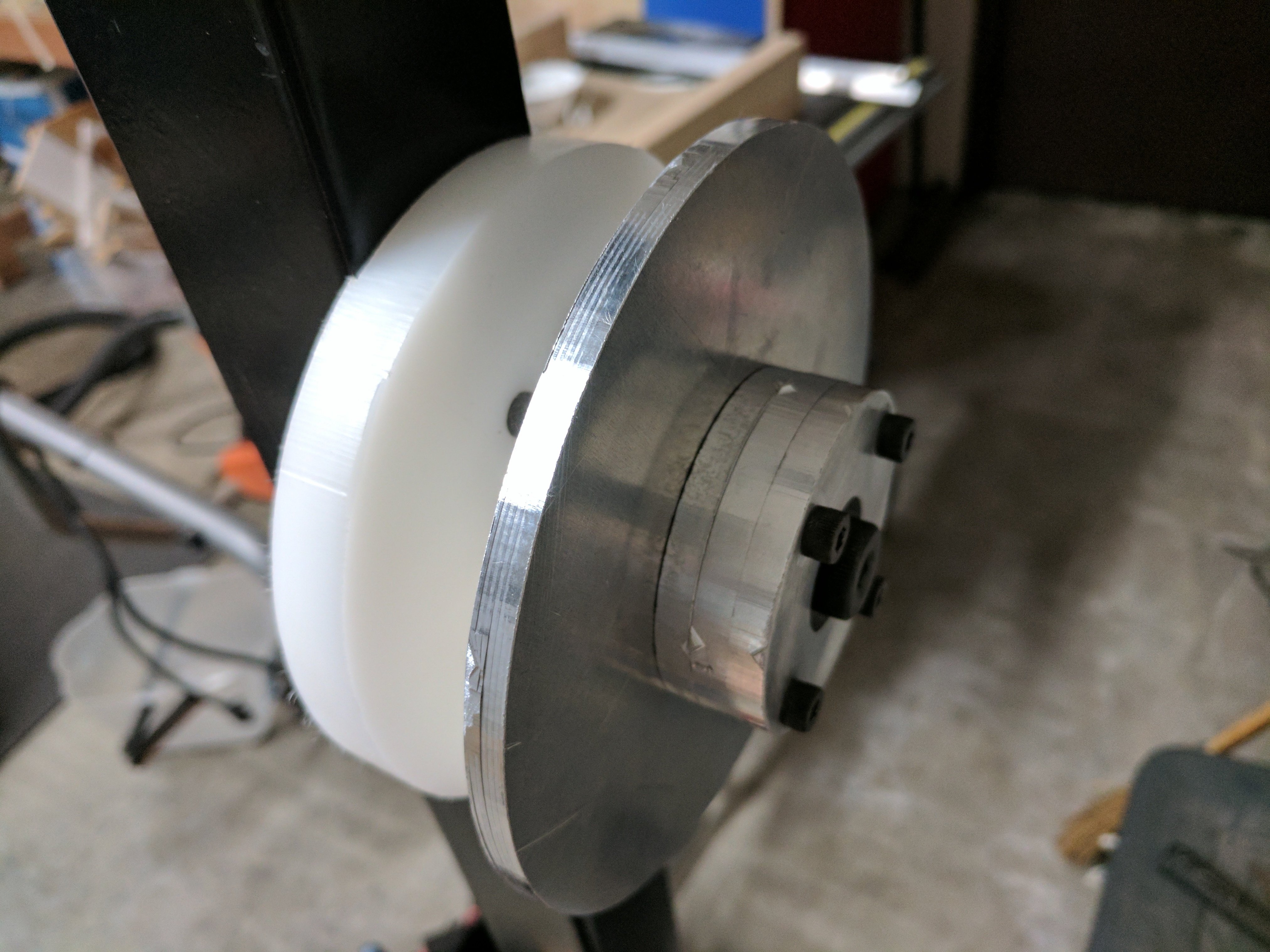

I’m building 3 double pendulums for an art piece for this years burning man. They’re going to be 8ft diameter (2x 2ft arms linked). The hubs where each pendulum attaches to the last will be 6" across and have 99 LEDs inside, while the arms will have 76 more LEDs spread along their length. The entire thing will have accelerometers and microcontrollers inside making the lights spin and move in response to the motion of the arms.
Assuming of course I successfully mill the huge stock of aluminum in my garage.
This high helix bit is scaring me. If i don’t cut deep then it produces very tiny very very hot chips and smokes my wd-40. If i cut deep I get a bit of chatter. I think I’ll probably need to do some kind of trochoidal milling if I want to use it effectively.
