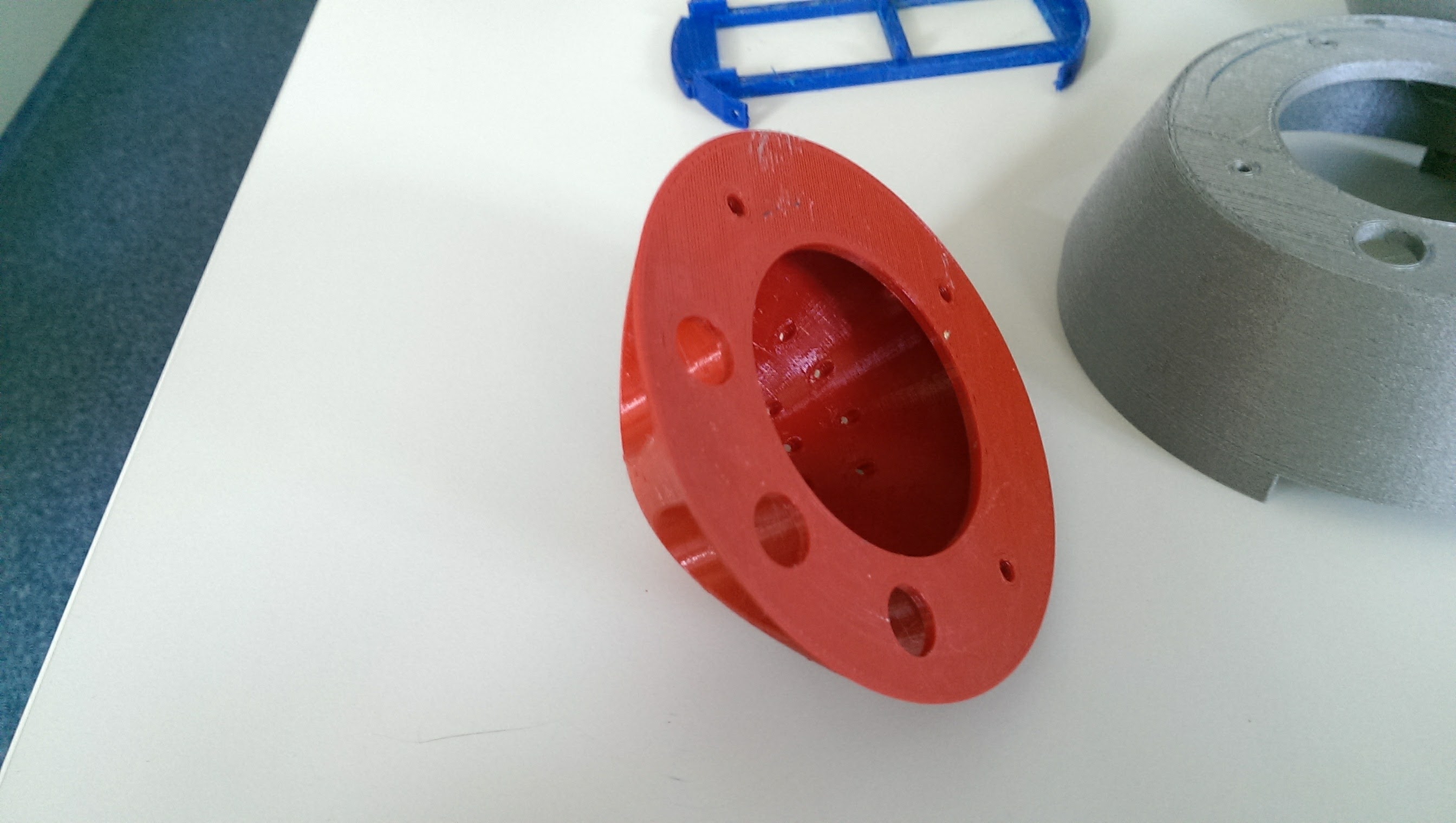

My biggest and longest print so far: http://www.tilman.de/projekte/musikrakete
The base took slightly over 9 hours, printed in PETG, 0,25 mm layer height, 80 mm/sec. Temperature was a tad bit too low, increased 10 degrees to 235 on the other parts.
