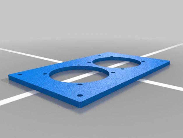

Ya at the board with this fan mount i made.
